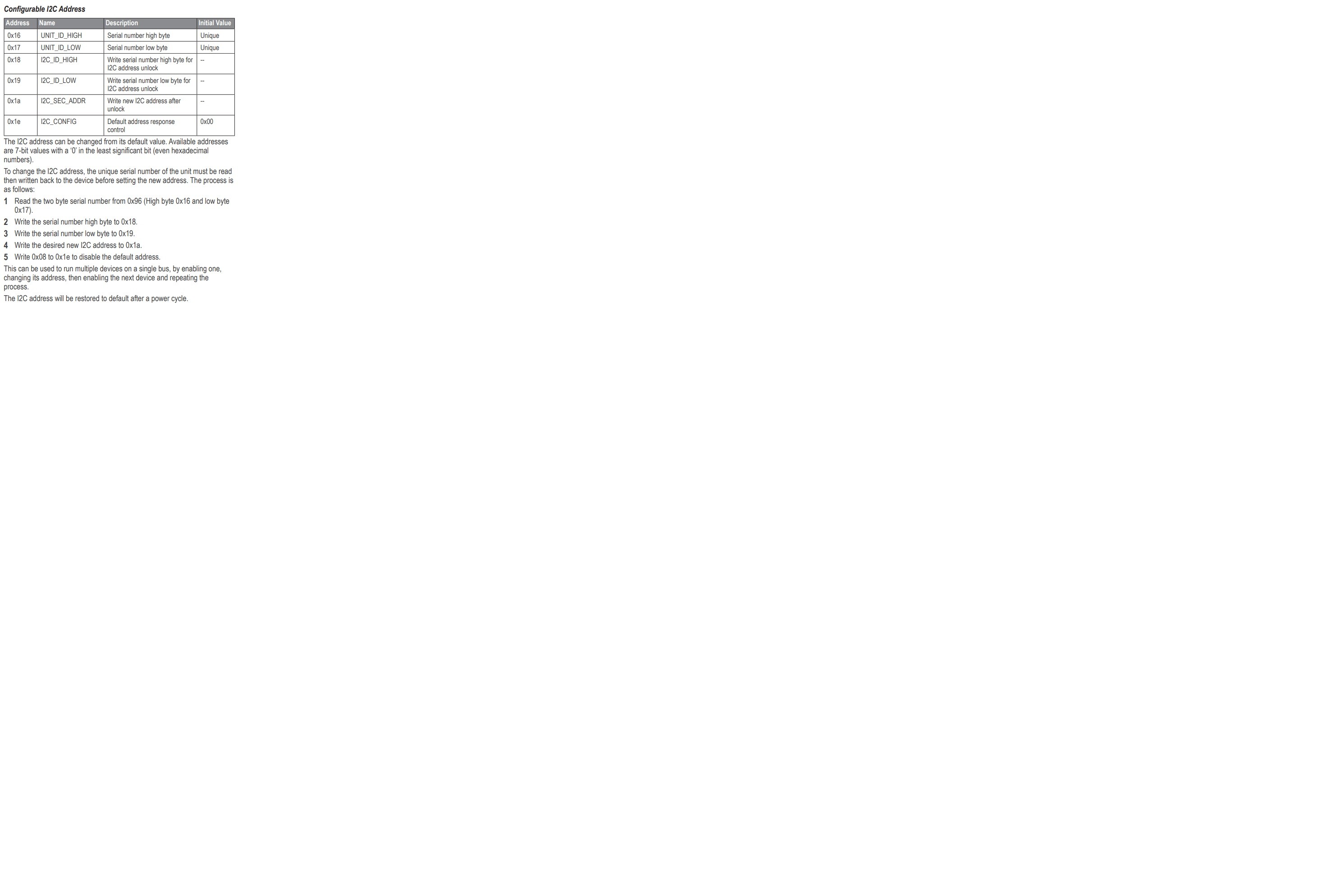

According to one discussion, I need to turn off the sensors, turn one on, change its address and then to the same for the second one, so I don't change the address for all sensors. I tried to do this:

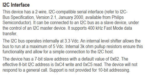

According to the documentation, this is the standard address every sensor has. That's why I turn off two sensors so I can change the address only on the one that it turned on. Or am I wrong?

It looks like you are following the procedure described in the manual, but don't confuse the issue by starting with all three devices. Test the code with just one sensor before adding another.
This is the standard address of every sensor:
char lidarStd_ADDR = 0x62;    // Default address

I think I now understand what you mean.
This is the standard address:
Then all sensors, which still have this same standard address are turned off:
  digitalWrite(sensorLeft_EN, LOW);
  digitalWrite(sensorFront_EN, LOW);
  digitalWrite(sensorRight_EN, LOW);
I enable one and read its address:
  digitalWrite(sensorLeft_EN, HIGH);  // enable the left sensor
  uint8_t serialHigh, serialLow;      // 1. read the two byte serial number
  Wire.beginTransmission(lidarStd_ADDR);
  Wire.write(0x96);
  Wire.endTransmission(false);         // Don't release the bus
  Wire.requestFrom(lidarStd_ADDR, 2);  // Request 2 bytes
  if (Wire.available() >= 2) {
    serialHigh = Wire.read();
    serialLow = Wire.read();
Here I think I made a mistake:
  Wire.write(0x96);
I have to read the serial number from 0x96, not write it to. The transmission doen't get ended. But then in the next sequence, I try to begin the transmission to a sensor with an address, that doesn't yet exist, because I haven't changed it yet.
  Wire.beginTransmission(lidarLeft_ADDR);
Since the transmission hasn't ended above, I can delete this line and change the address.
I hope I understood your help correctly! Thank you!
