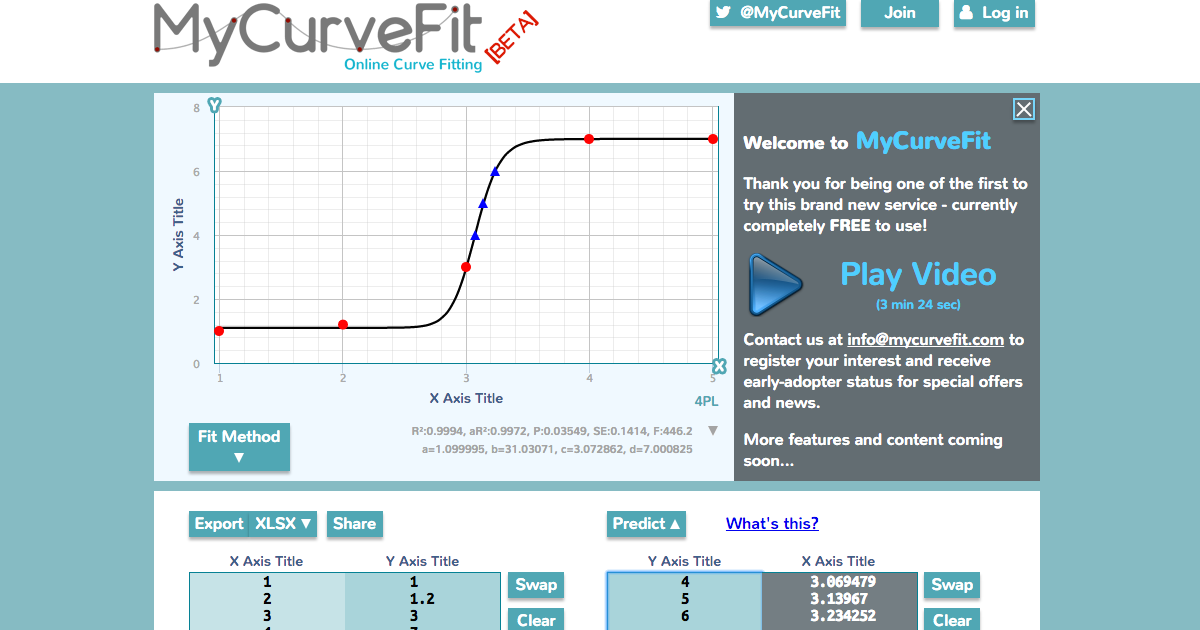

are you trying to doing something line a spline curve fitting?
See
where you can enter data and pick from a number of curve fitting functions.
I used RPM divided by 100 just to wrangle the numbers; thus is a quadratic fit:

Obvsly you'll want to put your own x, y pairs into the curve fitting code. Or use the website I linked in #7 above.
Your numbers are large on the output side so you'll get small coefficients, I used your RPM numbers divided by 100 or something like that.
a7
Reading off your chart I used these x, y pairs
10, 16
22, 60
30, 80
60, 70
as four points and used the curve fit site to caculate
   y = -0.06996 * x * x + 5.982 * x - 37.04;
The curve agrees nicely at least over the range you have provided.
