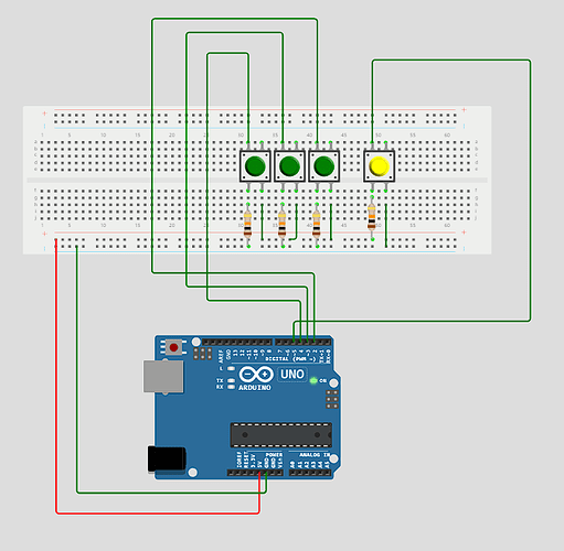

ahh you mean code. Yeah now the LED lights up, but without any press on the push button

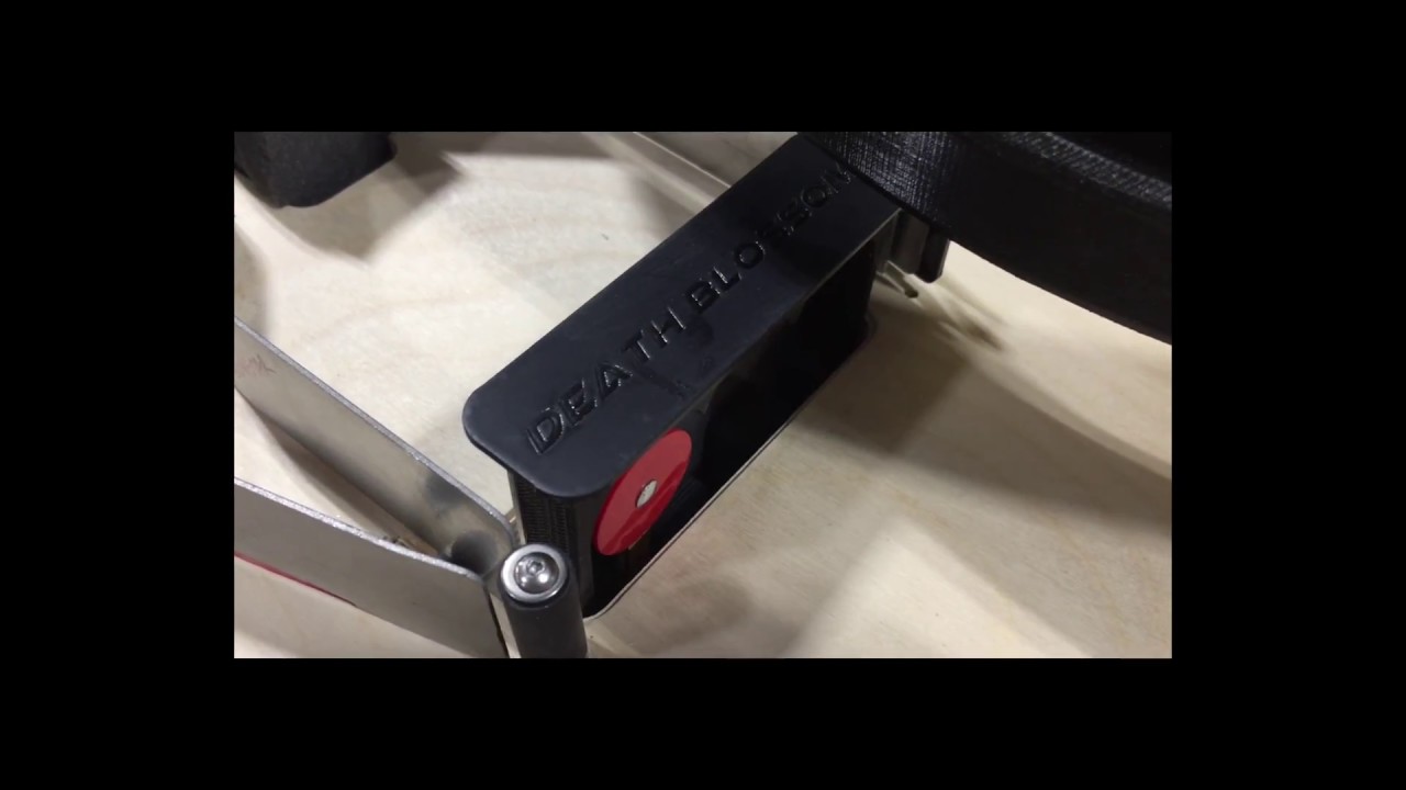

just for notice. This is the Target for me. Want to hit every target before the servo motor pull down the target bank. Reset Switch behind to come up again.

Well, I'm still confused as to whether the OP wants to push, latch and release each button or press all at the same time or... Maybe he/she will come back and clarify.
no i want to hit the button with a ball... so latch and release..but arduino must stil count as a hit for the target
OK. Here's a simplified version. Yes, I tested it and I think that I may have misunderstood this
One button more for LED goes off.
So I compensated for it with a separate button to reset the LED
Have fun.

dont work..can you make the code with an extern LED? Is my wiring correct?
okay work yet! Thank you so much!!! Problem was my wiring
