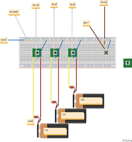

Hi, hoping for some help as i'm pulling my hair out. I build a single valve controller a while ago and had great results (https://petapixel.com/2016/06/04/build-diy-double-water-drip-system-high-speed-photos/), so i thought why not create a 3 valve controller. Using the same basic setup i have everything connected but when i press the button only 1 valve fires. I'm a absolute dope when it comes to programming does this look ok??

Do the other valves open if you test them with a short program that opens each in turn without the need to press a button ? How are the valves powered ? How much current do they take ?

Each valve, cables, reed switches work when i try them independently but when i combined them it only fires the valve connected to switch 10. Valves are powered by 12v battery which is looped through a reed switch.
You are using reed relays to switch the valves? Do you have flyback diodes in parallel with the relay coils? Can you post a wiring diagram? Also, a diagram of the valve piping.

I don't see anything obvious wrong with your code. What happens if you comment-out the few lines of code for the valve that works? Does that cause another valve to work?
I suspect an electrical problem.
Make a pencil drawing showing how you have everything connected and powered and post a photo of the drawing.
And post a link to the datasheet for the valves you are using.

Image from Reply #6 Original Post so we don't have to download it. See this Simple Image Guide
...R
Sorry, but I can't make sense of that Fritzing diagram. Please make a simple pencil drawing like I requested earlier.
What are the square green things?
Have you 3 separate power supplies?
Have they all got a common GND with the Arduino?
...R
apologies for the diagram, the green things are my attempt at showing Reed switches.
I have striped and rebuild the setup this time including an extra GND which is above pin 13 on the Arduino board plus a resistor on each cable going back to the board(Pin 8,9,10). It's now working.

What are the current ratings for your reed relays? Are they ALL the same? I have only seen reed relays used for logic circuits, not for power handling.
Paul
Hi Paul, I'm using 5V SIP-1A05 relays and there all the same.

The data sheet shows BLANKS for current rating. They are for logic switching, not current switching.
Paul
I had a similar problem when I build relay board for my arduino sometime back. Turned out that there is a sneak path thru the relays that interfered with their operation.
To fix it I had to put diode on each pin that drove a relay.
you also are lucky that without a flyback diode your arduino did not get damaged. Relays generally do generate a voltage spike when switch off that can be high enough to damage a uC/Transistor. flyback diode are there to clamp down that spike should it happen.

An apology does not make the diagram any easier to understand. A new non-Fritzing diagram is required. Taking the trouble to draw it may even identify the problem for you.
