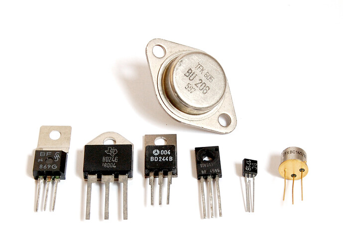

Can I ask if the relay = transistor ? Sorry I am a noob on electronics, I know more about fluid mechanics..
[/quote]
These are 2 different things.
A transistor is a silicon based device... really only useful for DC. It turns on and off really fast! (has 3 legs).
A solenoid is more like a manual switch it has 4 legs. 2 legs power the electro-magnet and then holds the button on. 2 legs for the 'output' of the button). A solenoid will do AC... HIGH voltage... HIGH current. but they are SLOW compared to transistors.

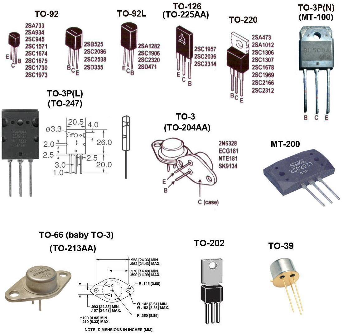

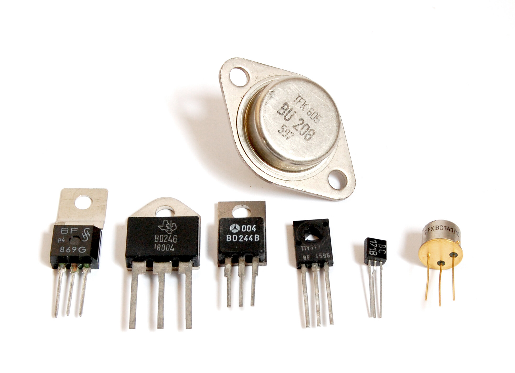

Jeff27:
These are relays
This is the circuit that transistor control the relay
These are Transistors
