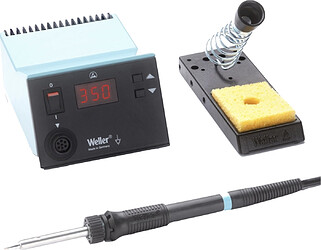

Hi @sierrra1
If it is for amateur use and small soldering on Arduino board and modules I recommend between 15W and 20W.
RV mineirin
I have one of these, it works great but it's output is only in °F and it drives me crazy.
Assuming you wish to solder at a minimum the headers and perhaps wires instead of the headers. You will need to consider the tip size. Ideally a chisel tip with a width of about 1/2 to 2/3 of the pad size. Maybe up to equal the pad size.

There are two versions probably , mine displays in celsius between 150 and 450
What soldering iron is that?
Did it come with a death adapter so you can plug the USA silly plug into a decent GPO?
In my opinion, for what it is worth, 50 to 60W, TEMPERATURE CONTROLLED.
TEMPERATURE CONTROLLED is the important bit. (pun intended)
