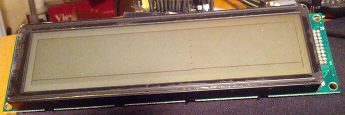

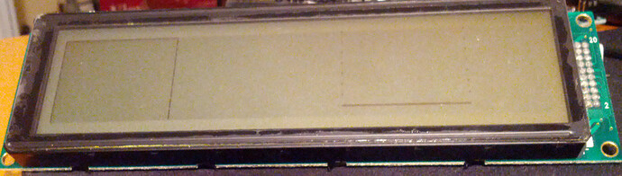

Thank you so much Oliver, the screen is now working perfectly!
Here is my u8g_dev_lc7981_320x64.c if you would like to add the device to the library
Note: Requires 16 bit mode
Tested with Varitronix MGLS32064-03.pdf
