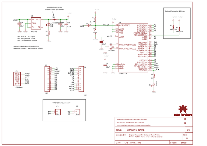

Hi !
I made 3 clones of arduino pro mini (8MHZ crystal - see photo and schematic below) without power supply (I give 5V from an external source).
The 3 boards have the same issue : no heart. Voltage is about 0.1V on xtal pins (about 2.5V on the pro mini).
Do I miss something to awake the oscillator/mcu ?
Thx for ideas
What do you mean by "no heart"?
Did you set the configuration fuses on the ATmega328P for the external crystal? The chips come from the factory configured to use the internal oscillator.
Oh ! thx

Test if the boards work, ie, if you can program them.
Cheap multimeters react oddly to high frequency signals, and connecting a probe to the crystal pins can be enough to stop it from oscillating.

Oh ! thx, I forgot that
I didnt try to communicate as I didnt see frequency on the cristal pins with the scope ^^
if it wouldn't be too much... do you have a "good" link to the bootloader upload and fuse programming ?
The best option for the ATmega328P is MiniCore:
After installing MiniCore, following the instructions at the link above, you can do this to set the fuses and upload the bootloader:
  • Tools > Board > ATmega328
  • Tools > Clock > 8 MHz external
  • Tools > Programmer > select the ISP programmer you are using. If you don't own an ISP programmer, you can use a spare Arduino board as an "Arduino as ISP".
  • Tools > Burn Bootloader
Burn bootloader sets the fuses as well as uploading the bootloader. After doing this. Make sure to always use the same Tools > Board and Tools > Clock menu options when uploading to your board.
