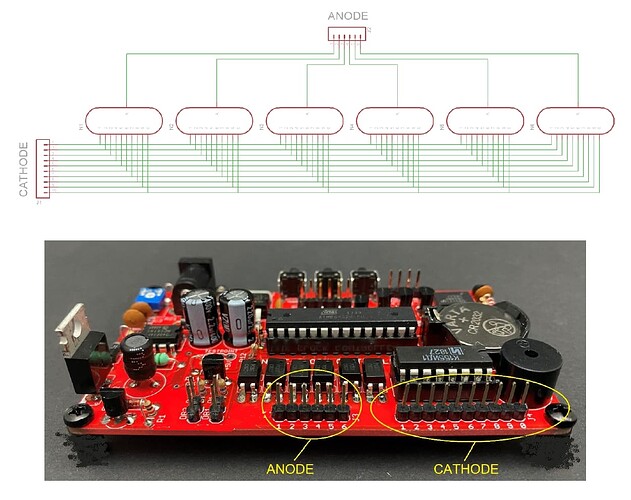

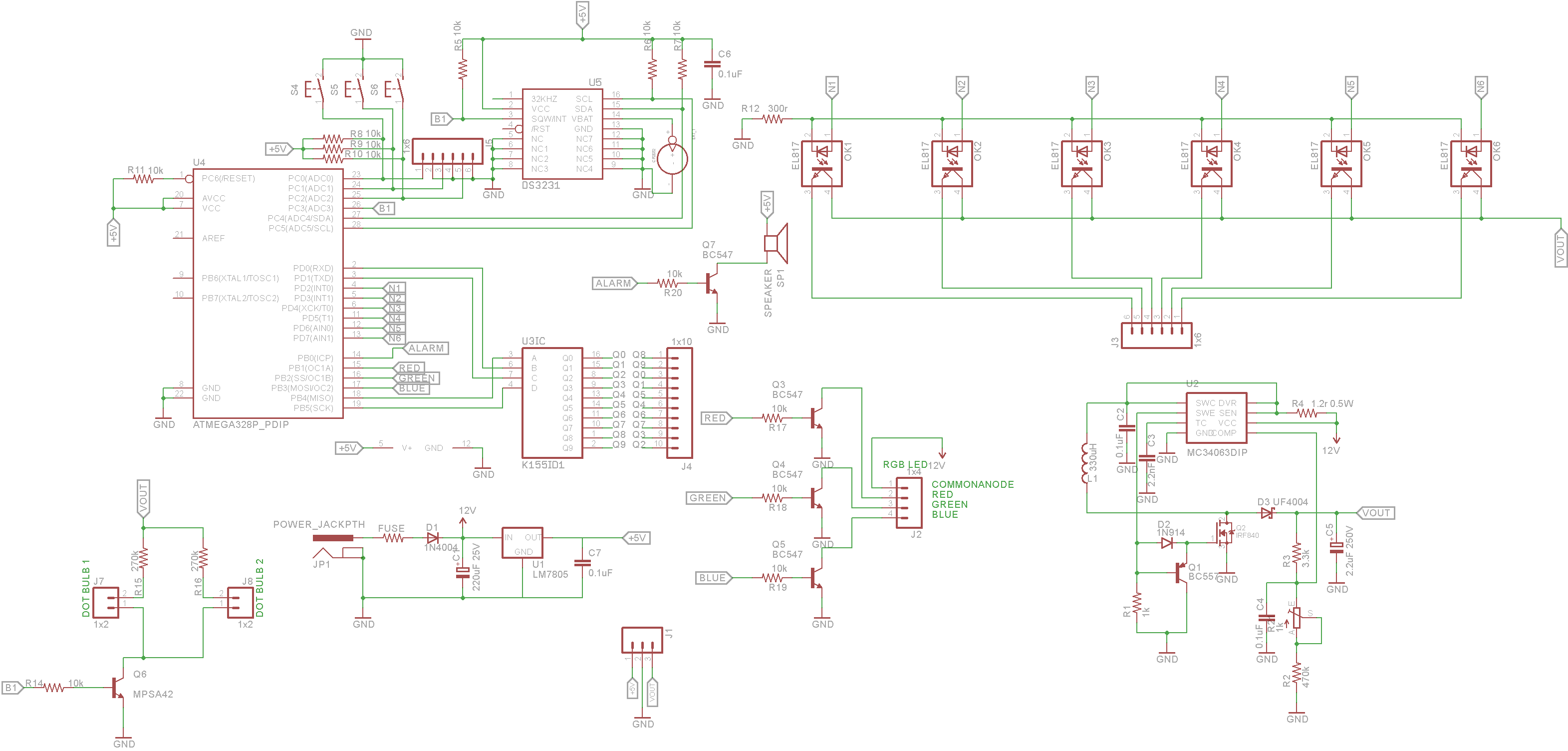

I have a Nixie Clock kit bought 3 kits and the ATMEGA328P were bad and the seller won't replace the 328P's or send me the Hex file so I can get these kits working. I suck at programming but very good with hardware. I have a full schematic and would need some help making a sketch and get these Nixie clocks working.
I'd prefer if I can get a very simple sketch working enough to were this guy will replace the three 328P's that are bad. I put the chips in my programmer and it reads I don't have a chip in the programmer to program! I tried to explain this to them and they are saying they don't understand what was wrong. Pretty sad right!! and not supporting their product!! I'd be willing to Pay or give a working kit to whom ever helps.
The 328P is hooked up to a K155ИД1 that drives the 6 tube cathodes segments and 6 opto-isolators that strobe the Anodes to the separate Nixies and also uses a DS3231 for the time base. Like I said I could also send the schematic to where these signals come out of the 328P.

From that schematic fragment which you posted (post #9) it is clear that there is no crystal on that board so it is running at 8MHz (probably). This could limit your options if you are using Arduino to develop software for it, for example, you can't just develop a program on an Arduino Uno then lift the chip out of the Uno and put into that Nixie clock. When you provide a full schematic and tell more about where you got the thing from and what programmer you are attempting to use, you may may get more specific advice.
from post #9

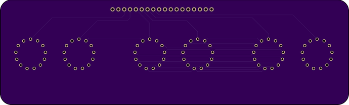

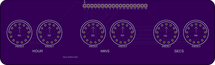

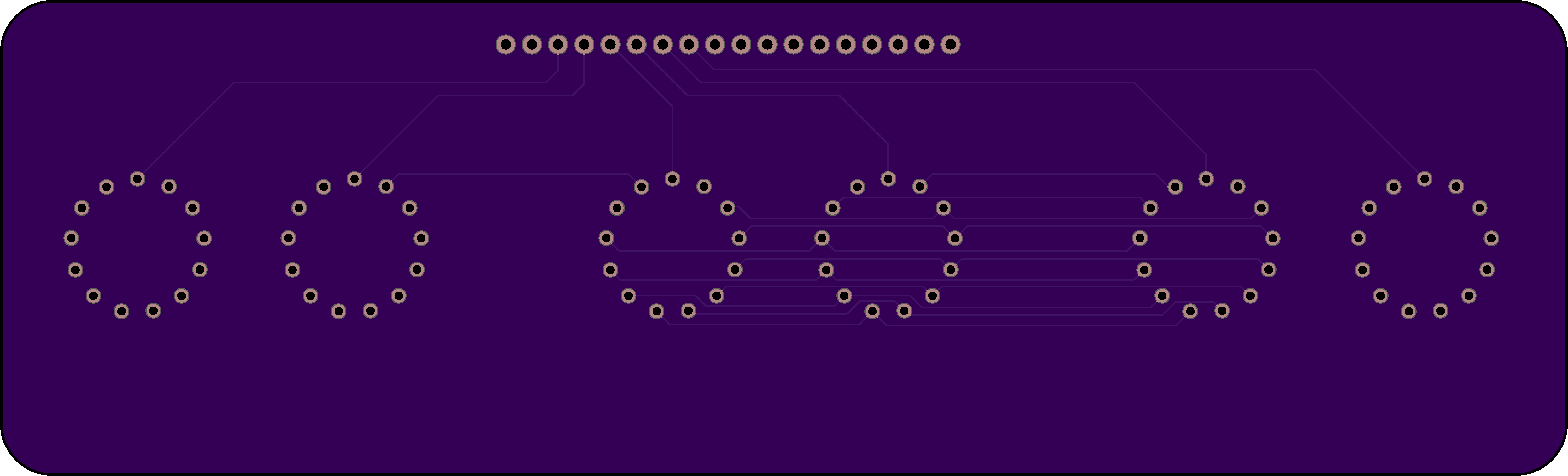

So I guess I still have something set wrong. I know I have my tubes hooked up correctly. I even made a PCB that holds the Nixies and wired like the picture attached. I'll check a few more things maybe I missed something.
