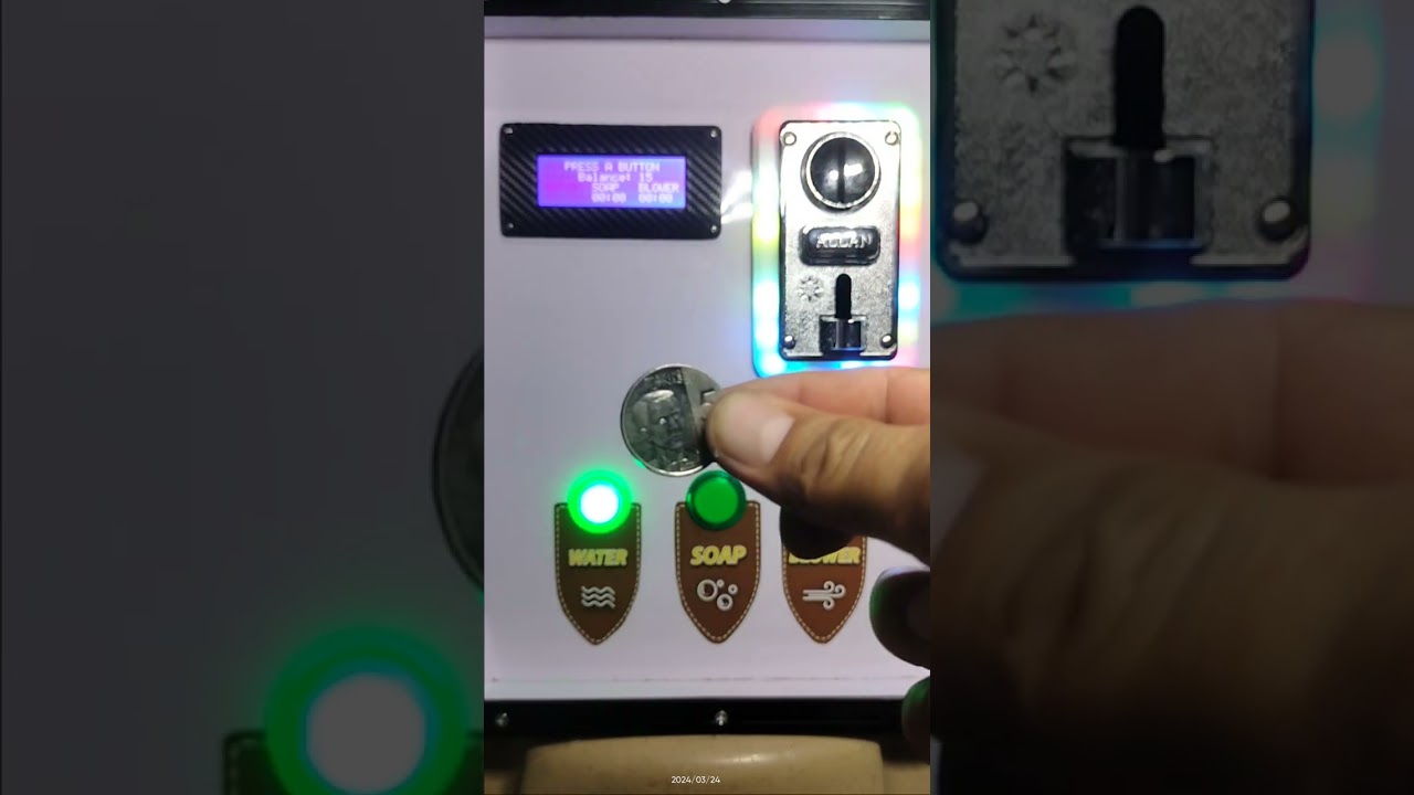

3in1 carwash vendo machine
hello everyone I just want to ask for help with my project which is a 3 in 1 carwash vending machine. I am using an Arduino Uno, I2C 20x4, 3 buttons, and 3 relays for Water, Soap, and Blower, along with a coin slot. My problem with the code is that it shows a credit balance: when I press the buttons, it doesn't give time to each relay. I've been troubleshooting this for almost 4 weeks and it still doesn't work. I'm just a beginner in coding, and I hope someone can help me for my personal use. below is the code i am using.

Hello nicole0229
Welcome to the best Arduino forum ever :slight_smile:
My tip from practical experience:
Build your own logic analyser using Serial.println("what I want to know") at program locations that interest you.
Who wrote the programme?
i am getting guide from AI on what to do for reference only
I have taken a high-level flight about your code and read your description.
Can we say this is a controller that accepts money, and if there is sufficient funds allows an operator to turn on and off soap, water and blowing?
What is the difference between soap, for example, being on but paused and off?
Your workhouse function handleButton() has an uncountable number of parameters, this is certainly an area where a better design would be, um, better.
Since the three things being purchased and dispensed are very similar, I woukd suggest you to look into structured variables, the keyword in C/C++ is struct.
Structured variables are a way to package up all the little things that are associated with one product, or in computer terms, one object.
An array of three of those identical structures might be useful; in this way talking about any of them would only need to be done by number. Numbers can be given symbolic names, and you code would become something more people might be willing to help with.
As it is, the task of finding the one flaw you are talking about having battled with for weeks is a huge one, and too much to expect from casual or even not-so-casual helpers.
This can best be expressed by saying you need to learn more about some better language features and try again.
I am in agreement with @paulpaulson - you make little use of the easiest debugging tool, serial printing. Make your code talk verbosely, telling you where it is and by printing also the values of key variables, why.
I saw this hours ago and thought I'd take another run at it later. It's later now but too early to tell if I am alone in my assessment.
Since you are using AI, you might feed this hole mess to it and kindly request that it try to show you how handleButton could be done differently if all its parameters were members one structured variable. Just for fun.
But in the abstract, this is a simple sketch.
Another thing that might help is if you put aside for now your plan to use an LCD. Just now it makes things harder to read, modify or fix. Once you have the essential logic talking good sense over the serial monitor, go back and imllement the fancy display.
I could and do say the same thing about messing with relays. Until you can make LEDs or print statements perform the equivalent actions, leave the hardware off to the side.
It's all about dividing for the purpose on conquering.
a7
Warning: this was written by chatPGT, prompted
I will paste an Arduino sketch that is meant to control a car wash, selling water, soap and some kind of fan ("blower"). Please rewrite it using an array of structs. The struct should have at least all the parameters that are currently scalar and appear in the function "handleButton".
I have not yet read it, I'm saving that as a reward for doing some house cleaning and I must at least start working on my taxes first:

that code comes from deepseek
this is the sample video i want to achieve
