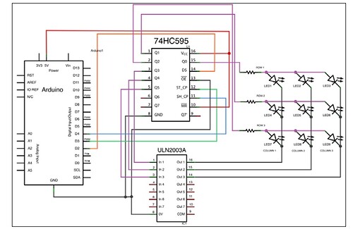

Hello, I am reading book „C Programming for Arduino” and I am not sure am I understand something wrong, or is there a mistake in the book.
So here is the code:

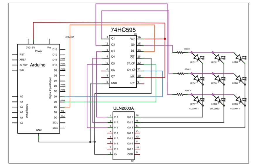

I do not have shift registers so I am unable to test out this sketch by my own.
Confusion starts in line ” if (LED_states[currentLed]) dataRow = 1 << (4 - c);”.
Isn't there suppose to be (8-c) instead of (4-c) , due to sum of two half bytes in continue?
