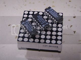

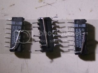

It would suck if you had made a mistake.
So, does each register do one of the following: red, green, rows?
If so, isn't there a risk of current damaging the leds (don't see resistors) or current damaging the rows register (don't think it can sink that much)?
Now, you just need to use one of the mini arduinos (nano, mini, etc) and just attach to the back, and then you have a super-compact led matrix!
Nice work!

595 595 595 Freeduino
PIN 16 <==> PIN 16 <==> PIN 16 ====> digital pin 13
PIN 12 <==> PIN 12 <==> PIN 12 ====> digital pin 8
PIN 11 <==> PIN 11 <==> PIN 11 ====> digital pin 12
pin 14 ======================> digital pin 9
pin 14 =============> digital pin 10
pin 14 ====> digital pin 11

Nice project, and good soldering skills, but you are powering all the 75hc595 from one arduino digital pin, and thats pretty risk, you can(and will) burn your arduino.
