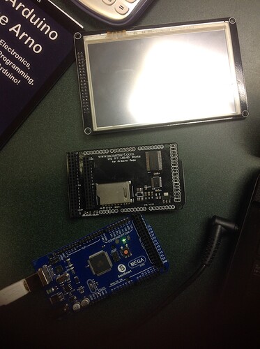

Hello All
I have a 4.3 inch LCD touch screen and i also have the TFT LCD/SD shield and an arduino Mega 2560
I want to use the touch screen and program it to display what i want but i don't know how and i don't know where to start can anyone help me with that?
Do you have a library for the TFT screen? Where did you get it?
Hello and welcome
You need to know the controller that is used on this display.
By looking at your picture, that TFT seem to be big for a 4.3". It looks more like 5", like this one.
Your TFT controller is probably SSD1963, so it can be driven by the UTFT library.
