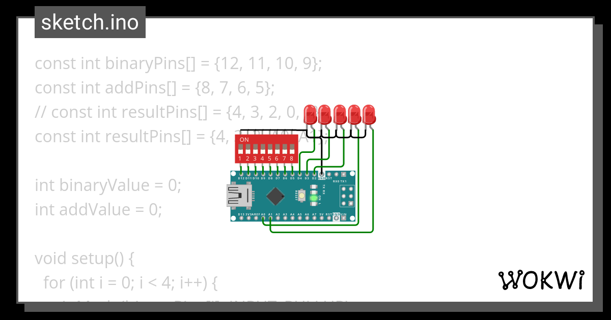

Its supose to show the numbers being added up (modified with slide switchs) and the result as the series of LEDs (on and off) that makes up the number, but testing the code, it just doesnt work, it only turns up the LEDs of the result (except for the carry).
Also Im asked to see if I can change the use of slide switchs for buttons.
I'm not very good at python, and I really dont want to waste anyones time, but I wanted to see if someone could help. I would really want learn how to fix these and would appreciate any help.
Just now also they gave us these code which does uses the buttons, but it still doesnt work on the test:

Pins 0 and 1 are usually reserved for communication. You might try using two of A0-A5 instead.
I am not sure what "working" is, but the second code works.

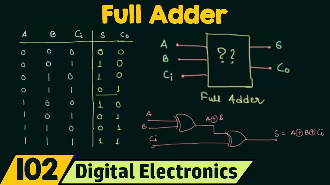

The point is you need the carry output....Otherwise 1110 + 0 is just the same as 1111 + 1111.
Without carry output.
1110 + 0000 = 1110
1111 + 1111 = 1110
With carry output.
1110 + 0000 = 0 1110
1111 + 1111 = 1 1110
Take a view here to gain the knowledge:

Thanks....I myself know full adders, half adders etc.
Unfortunately I'm not especially gifted with the skill of writing out in-depth explanations of things....I forgot about youtube too.
