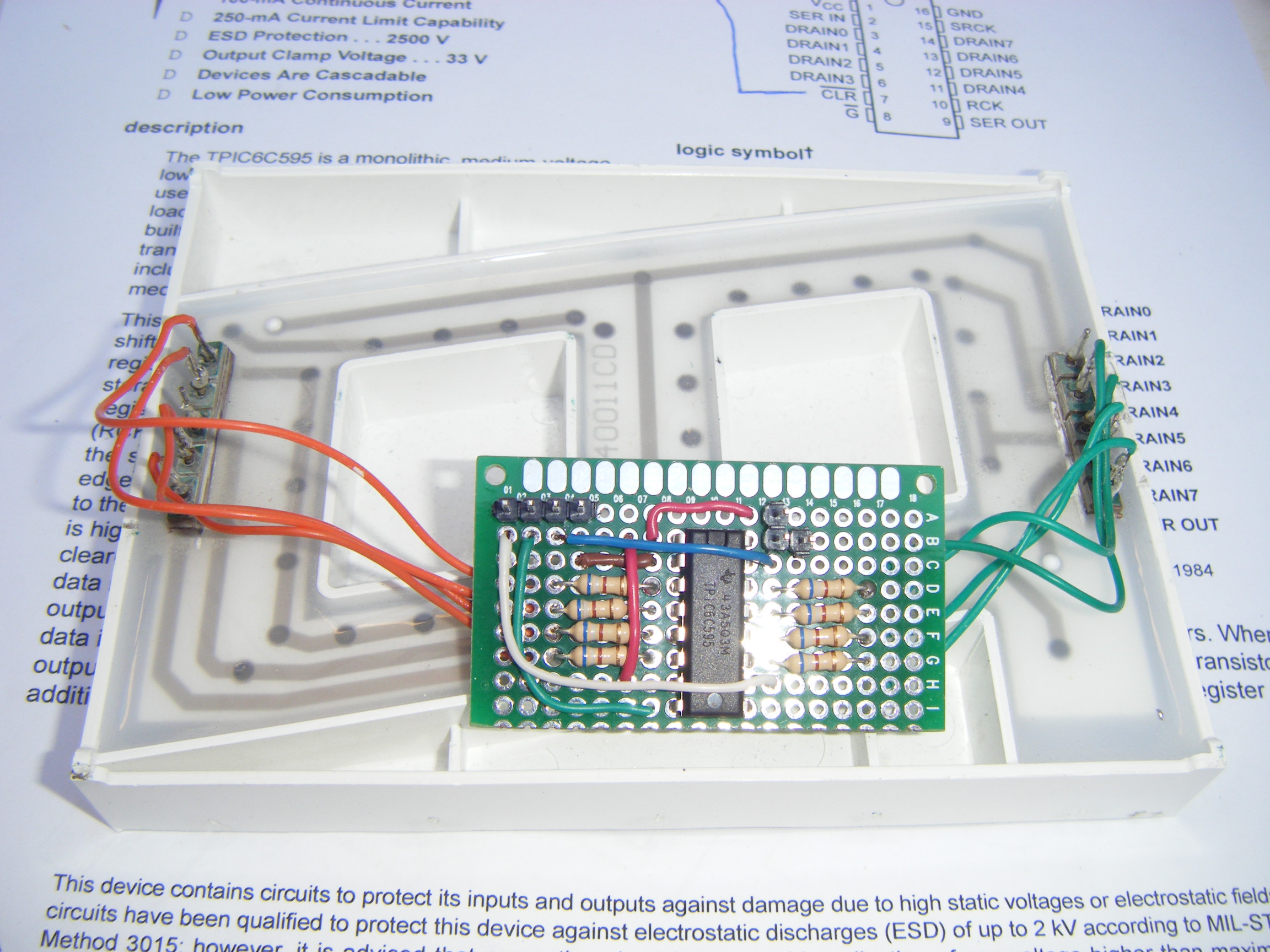

I would like to drive a 4" large 7-segments LED with my arduino nano.
This 7-segments is common anode
and 12V driven.
I have understood I have to use a Constant-Current LED Sink Driver
(sink and not source because of common anode).
I wish you could tell me what reference of driver I could buy in 2014?
as I have googled many threads but often the chip references are outdated... :~
(Allegro 6278EAT from this post on deleteaso.com)
Could you please tell me what I can buy?
Thanks
yours
Mat
PS : I know there is an alternative but I would like to not use 7 NPN transistors and 14 resistors to simplify the wiring.

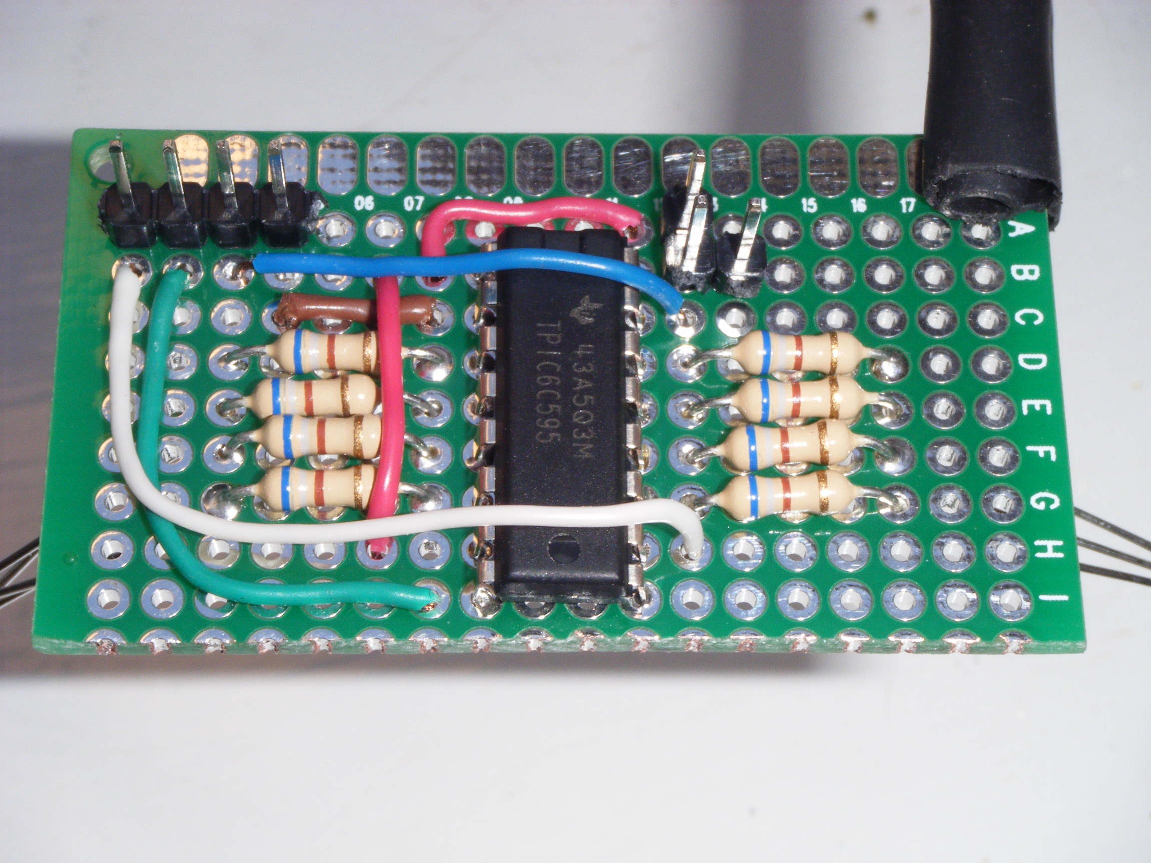

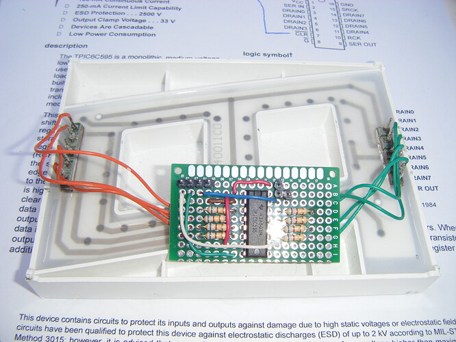

edit : here is what I have done
thanks to PaulRB, CrossRoads, Grumpy_Mike, Paul__B !
-> job done with TPIC6C595
see in attachement PCB and wiring diagram
- arduino SPI library
Here is the result in video!
Thanks guys for the help so far!
Shift Register Example for 74HC595 shift register by Tom Igoe
Digital Pot Control by Tom Igoe
Thanks to Heather Dewey-Hagborg for the original tutorial, 2005
Thanks to CrossRoads!
by RacingMat 09-2014

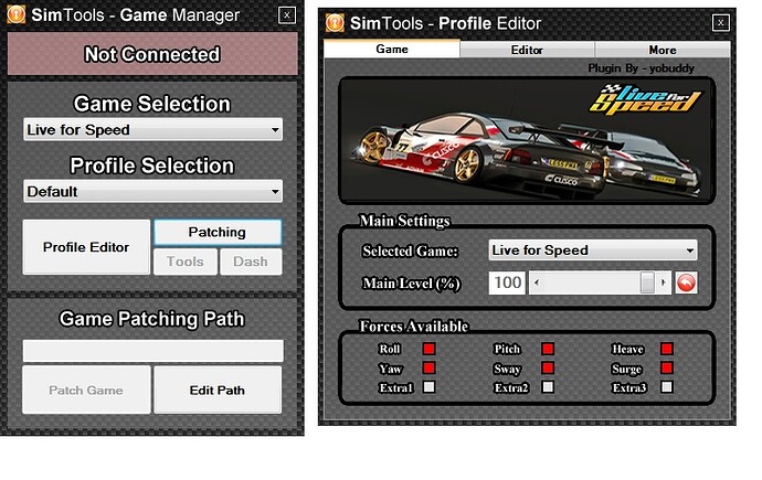

Physically how will the digit to display be transmitted to the Arduino?
It is via a USB com port
There are two free softwares which can drive actuators for dynamic simulators and dashboard incidentally
-Simtools software
-xSim software with an example of more complex digital dashboard
