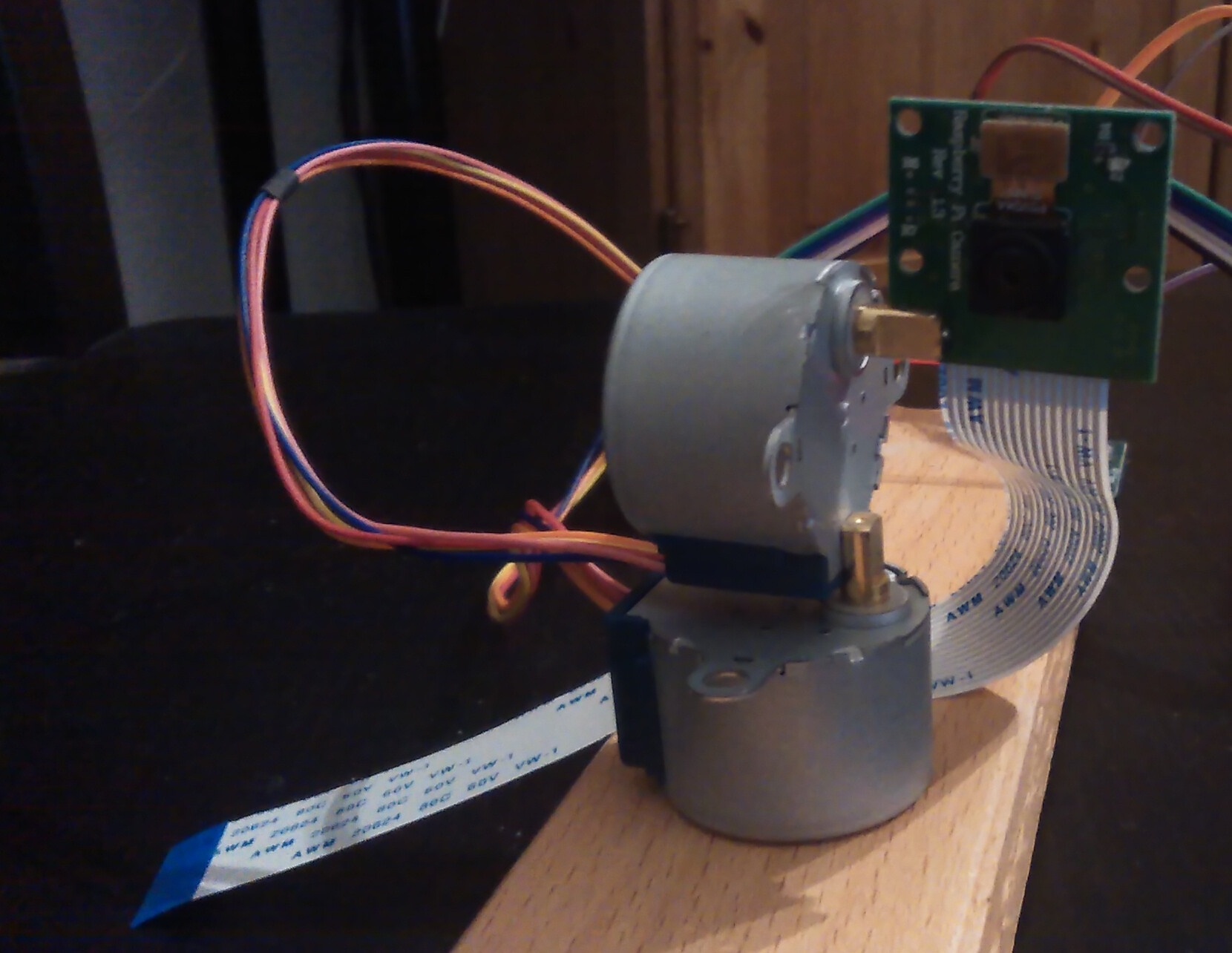

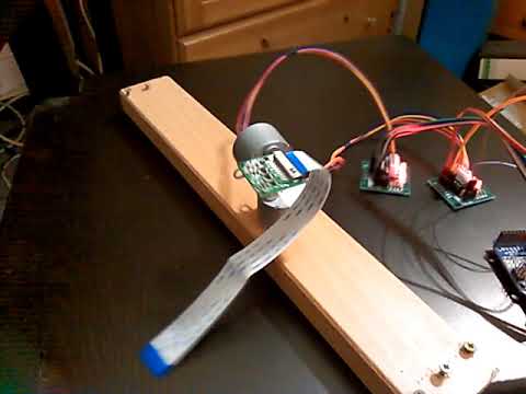

4 drops of superglue are enough to create a high precision PT system!
Servos have range 0..180° with 180 steps (1 step/°).
28BYJ-48 has unlimited range and 4096 steps per 360° (11.3 steps/°).
1st drop of superglue between ground plate and bottom steper motor.
2nd drop to fixate 4 cables leaving upper stepper horizontally.
3rd drop to fixate upper 28BYJ-48 directly on motor shaft of bottom stepper motor.
4th drop to fixate Raspberry v1 camera on upper stepper motor shaft.
That's all -- I don't know why I every used servos for PT camera system.

I did it, moved the 70mm lens from servo PT camera system to stepper PT system.
Upper stepper+lens weight is 36.4g+19.1g=55.5g -- lower stepper and superglue have no problems to deal with this.

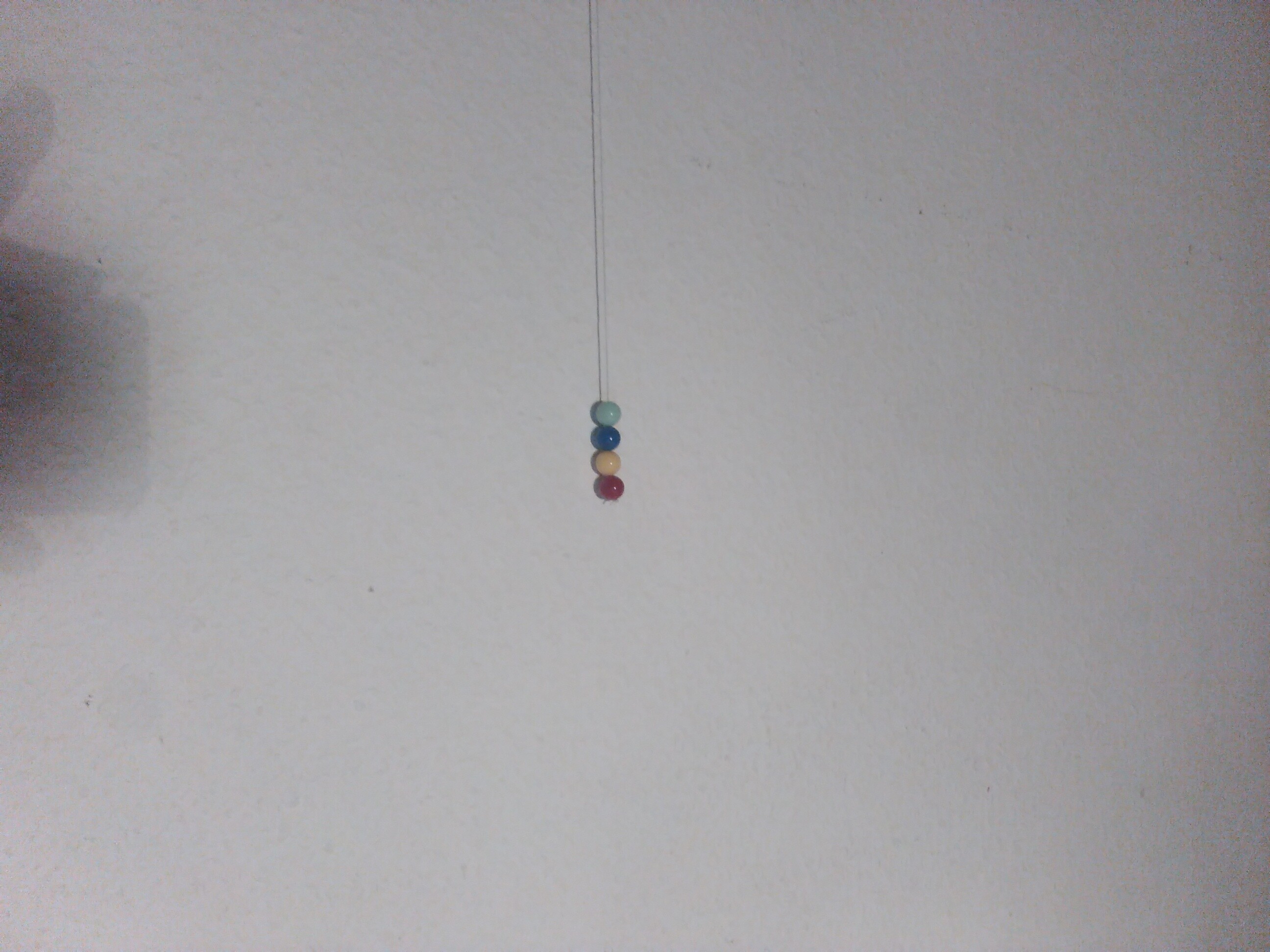

Based on all the code I have already, I would expect automatic centering of video on swinging red ball while recording video tomorrow (1920x1080@30fps and 640x480@90fps).

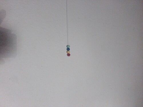

Until now photos/videos were not from the stepper PT system camera.
Before continuing I needed to check what the videos captured will look like.
I used the fast movement from before (delay 1ms between steps).
And new move tool for positioning:
https://www.raspberrypi.org/forums/viewtopic.php?f=33&t=256740&p=1565748#p1566020

I did record 1920x1080@30fps video with this command:
$ raspivid -md 1 -w 1920 -h 1080 -p 22,50,960,540 --shutter 10000 -t 5000 -o tst.h264
Option "--shutter 10000" sets exposure to 1/100 second. It is needed to see clear frames:
I wanted to show the video here, and I wanted to be able to show details.
Therefore I slowed it down by factor 3.
Unfortunately the generated 1920x1080 animated .gif is 107MB in size.
So while creating the .gif I scaled down by factor 6 to 320x180, with only 3.5MB size:
I think the speed should suffice for tracking pendulum -- origianl speed is 3 times faster.
And it is far more than needed when tracking real airplane in sky.
Next step is to determine for pendulum, how many pixels in generated frame correspond to a single stepper motor step up, down, left and right.

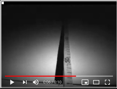

Stepper motor does not seem to loose any steps at 0.8ms/step speed, 10 far moving repeats:

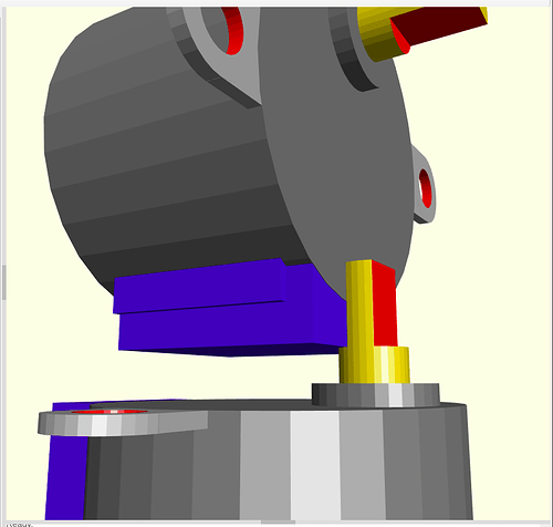

To be more precise on building instructions, this is the central superglue connection between the two 28BYJ-48 stepper motors [feels like the motor shaft was built for exactly that ;-)]:
The OpenScad file is based on RGriffoGoes' thingverse OpenScad model of single 28BYJ-48 stepper motor.
My modified file is here:
You can open the OpenScad.net share link and press F4 to redraw as well.
I did complete the OpenScad modelling by adding Raspberry camera as well as wood base.
I learned how to pass an argument (angle) to "StepMotor28BYJ(-45)" module, the share link:
https://tinyurl.com/t7kyfug

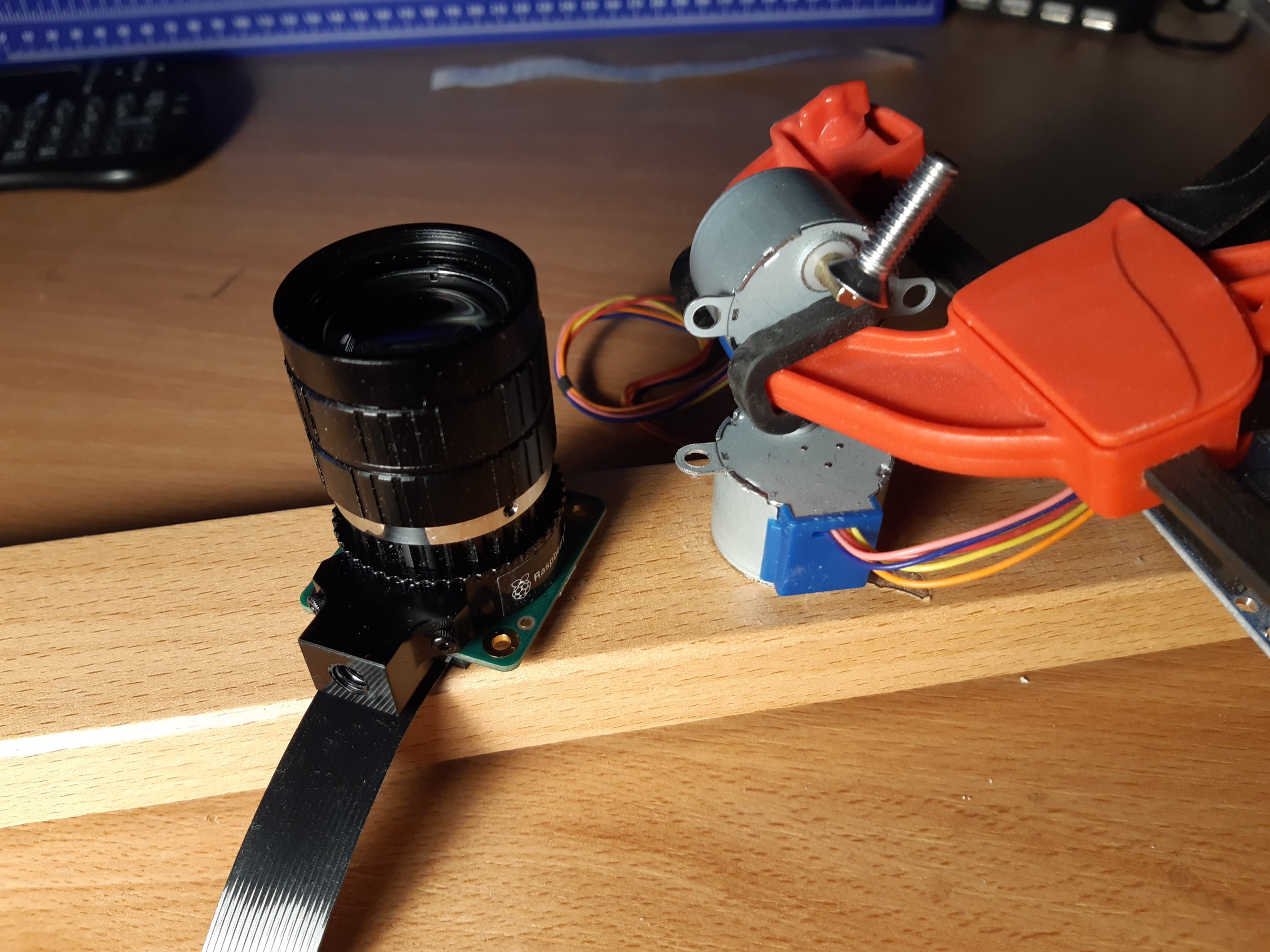

Today I played with Raspberry HQ camera and C-mount 35mm lens. Both together do weigh 109g together, with the top stepper 19g that is 128g in total. I was not sure whether superglue would be strong enough and tried.
HQ camera comes with tripod mount, and I measured M6 with micrometer. So in addition to the two stepper motors I superglued a M6 screw:
And it really works — as long as the camera does not move too far to front or back, then steps get lost:

I just measured, and more than 12mm of M6x20 screw thread are not used.
So replacing M6x20 screw with M6x8 would bring everything closer to upper stepper motor shaft.
Then even 70° lens up should be possible:
That would be enough for capturing airplanes automatically centered

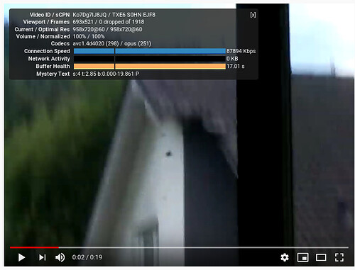

I did let the joystick alone, no movements.
The jitter (in the analog reads?) is really heavy, this is 0.5s real time animated .gif loop from Raspberry HQ camera mode4 (1012x760) video capture at 60fps (that mode can capture up to 120fps), scaled to 1/3rd size:
So today I created modified sketch with jitter filter.
Jitter remained with threshold 5, 10 and 15. No jitter with 20, sketch uses threshold=25 to be on safe side:

P.S:
Youtube video captured with new sketch:
P.P.S:

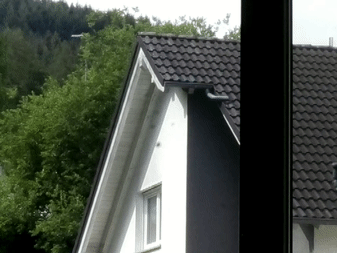

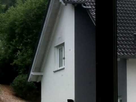

The 35mm lens is quite nice, this is 1:1 copy out from 12MP frame captured, the tower is 2.3km(!!) distant:
