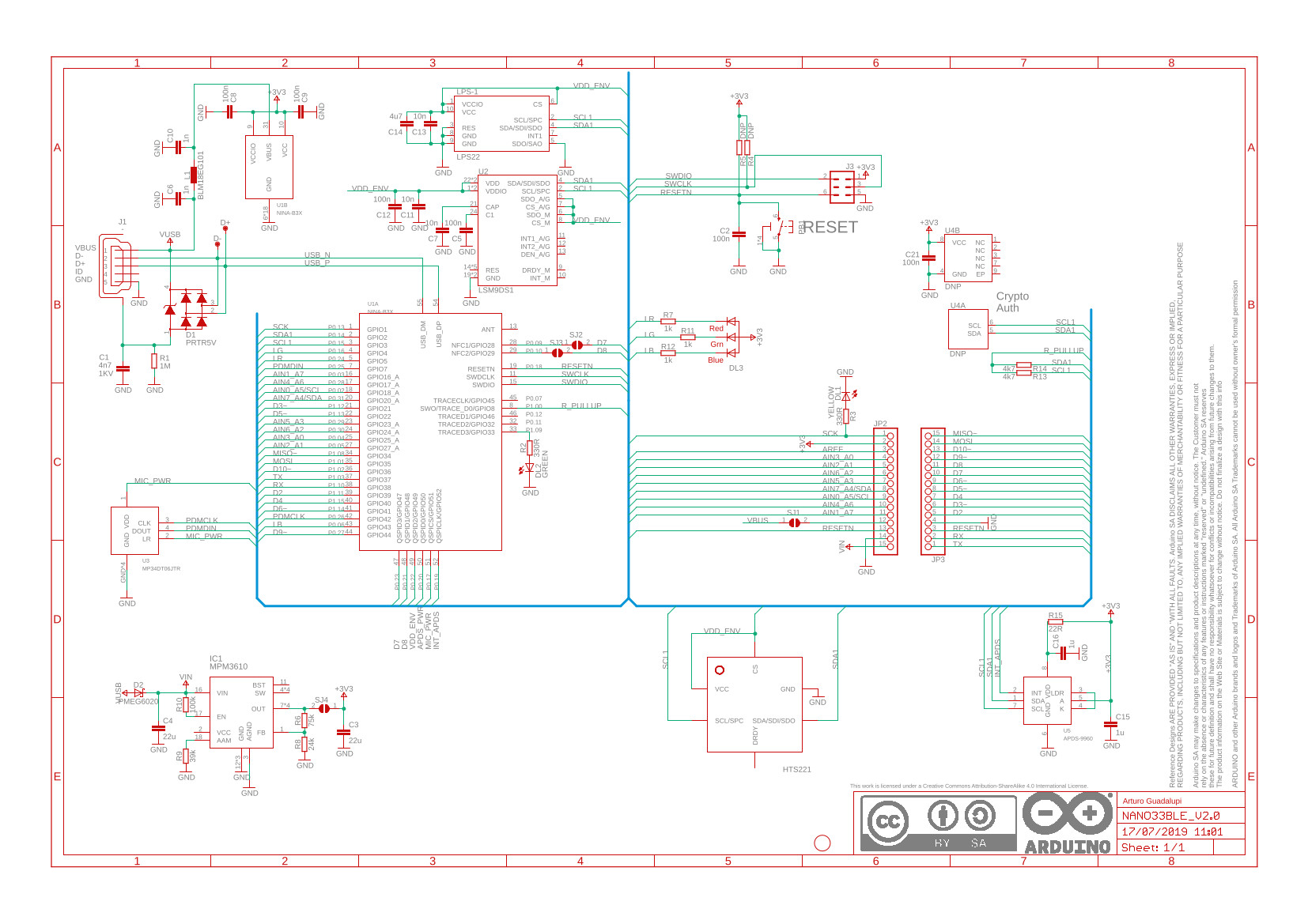

While reading about this on the Internet, I came across various numberings for the pins. I think this may be where I am going wrong. My pin numbers where based on this image from **https://www.makerguides.com/arduino-nano/**:

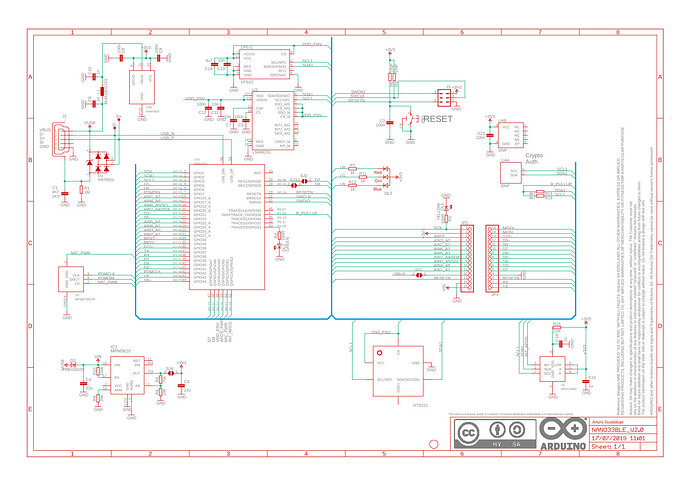

However, I also came across this schematics from **https://content.arduino.cc/assets/NANO33BLE_V2.0_sch.pdf**:
I also found a datasheet for the Arduino BLE 33 which appears to have even another pin numbering.
I've just tried to test the alternate pin numbering but I'm having trouble connecting to both of my BLE33s. It happens sometimes. Also, as an aside, sometimes when I load a sketch for the display, the display just remains blank. But, if this continues, I'll open a new topic.
In the meantime, can you provide any clarification on the pin numbering?
