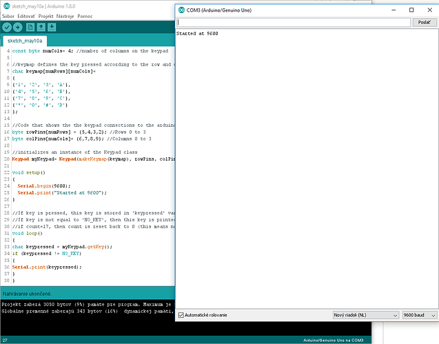

Hello, guys thanks for replies. I attached my serial and schematics. Please help. :frowning:
That is not a schematic.
It does not show the actual key connections, which is required to understand why your code does not appear to read the keypad.
You probably have the keypad wired incorrectly.
Finally, please note that "Started at 9600" was printed out, and this is not "noothing".
