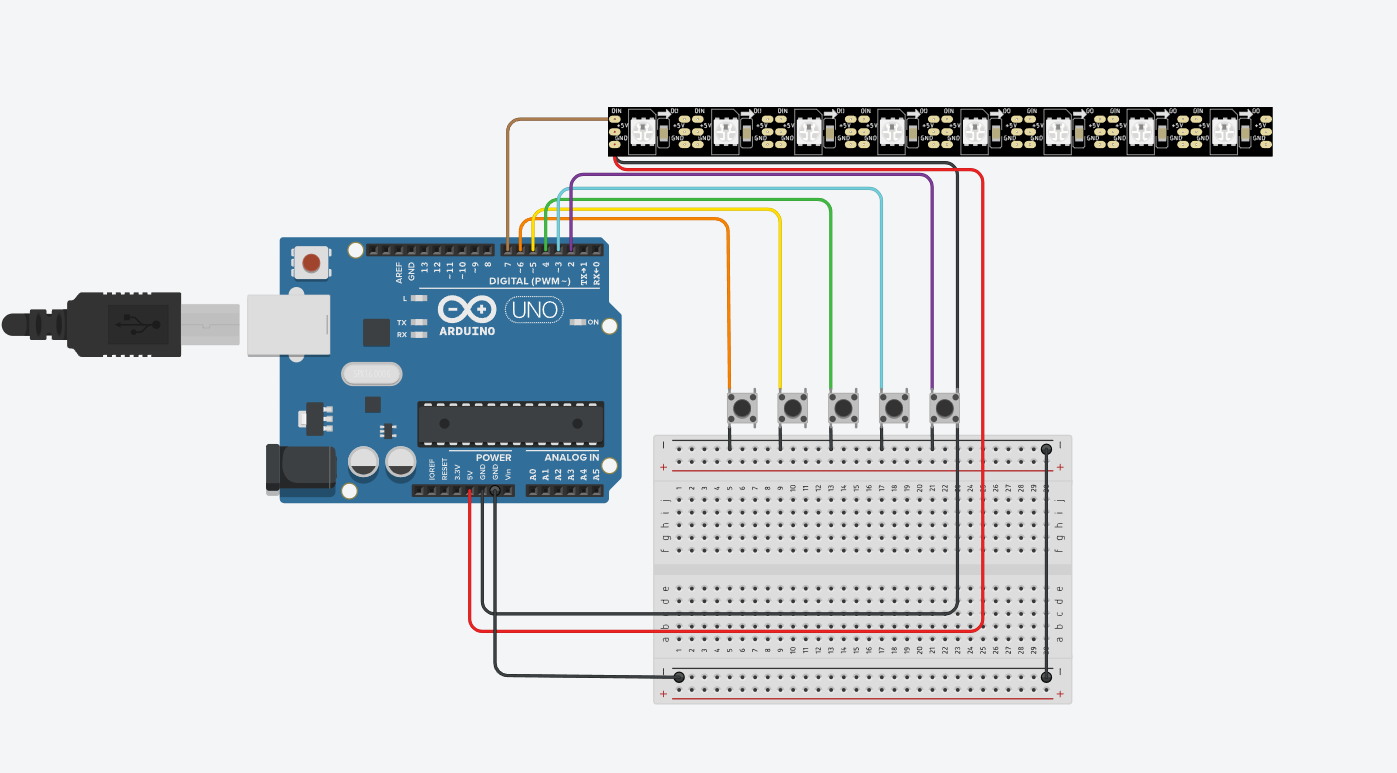

Hello everyone
I am new to arduino,
I am trying to connect 5 push buttons to NeoPixel Strip 8
The objective being, each button should trigger a specific blinking sequence.
(I am still learning how the code works, so I have asked chat GPT for the code)
Terminal 1b of all 5 buttons are connected to pins 2 to 6
Terminal 1a of all 5 buttons are connected to GND via a breadboard
DIN of the LED strip is connected to pin 7
5V & GND of the LED strip is connected to 5V & GND on the arduino
I am attaching a picture of my circuit and the code
Any help / guidance is much appreciated
Thank you :slight_smile:

This may destroy your Arduino. The 5V is incapable of providing enough current.

Pins 6,5,4,3,2 have duplicate purposes!

But I am using a strip that has 8 leds, its not a long one
And I want it to flash in red (based on what I read from the link you gave, red colour requires relatively less voltage)

Eight red LEDs should be well within the max current from a UNO’s 5V pin.

Its the connections that I am not sure of
Yeah, after I run the simulation and press the buttons, nothing happens
So I thought I must have made a mistake in the connection
5V is fine. It's the current to be concerned with.
Your Neopixel strip has the potential to draw ~500mA. That's fine as long as you are powering it with a USB device such was your computer. You will damage your Uno if you attempt to power it any other way.
Your code as written will not work on Neopixels. Provide a link to your strip

Is this your strip?
Yes, (I am doing this on Tinkercad Arduino Simulator)
But its the same thing
The first thing you need to do is install the library and get familiar with the examples
I doubt the capacitor is needed in such a short strip. However, be aware of glitches. Adding a 330 or 470 ohm resistor would be a good idea.

My main doubt is, did I connect everything correctly ?
(with reference to the picture I have attached)
Follow the examples. Get the Neo working first, then revisit the switches.
With the help of the examples I got the strip to work with a single push button
