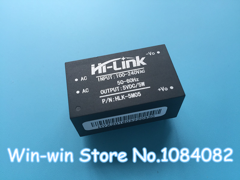

If budget allows then why not use this tiny little AC 220v to DC 5v module? it cost me about 4$ and it easily fits on my PCB and breadboard. ![]()
module name Hi-Link HLK-5M05
It has a built in transformer and capacitors, in case you're wondering if it's just a cheap 4 rectifier diode inside that tiny box.

If budget allows then why not use this tiny little AC 220v to DC 5v module? it cost me about 4$ and it easily fits on my PCB and breadboard.module name Hi-Link HLK-5M05
I think that module can run at 5V, 0.6 Amp continuously. The OP reckons they need 1 Amp.
its a 1amp module
