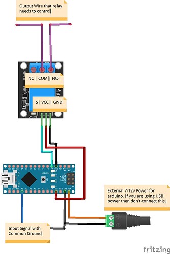

Hey I’m working on a project that will take 12v power and trigger a 5v relay when 0v-5v is applied to AO pin on the Arduino Nano! But currently have everything setup on a breadboard and when I turn on power to the breadboard, the Arduino nano and relay power up but the relay is triggered every 5-7 seconds, on and back off? When the relay should only be triggered when anything more then 0.5v is put into the AO pin, Here is the wiring diagram I’m following! Appreciate any help or input on this project!

What is the source of the voltage?
It’s just one of these guys from Amazon, may that be my issue?!
5PCS 5V 1 Channel Relay Module... 5PCS 5V 1 Channel Relay Module Low Level Trigger, Modules - Amazon Canada
It’s a throttle signal, 0.45v is idle, and 5v would be wide open throttle! That’s why I have it set to trigger relay at 0.5v so after throttle is pressed I’m wanting the relay to turn on!
Disconnect the throttle signal and connect 5 V to A0, see what happens.
No schematic of the relay board; that's unfortunate. I don't see an optoisolator, just what's probably an NPN transistor to (hopefully) boost the current to the coil.
And you are powering the relay from the Arduino's 5V pin? You might want to measure the current draw. It's possible it's enough to put the Arduino's 5V regulator into thermal shutdown. Engage, heat up, shutdown, cool down, reboot, repeat.
The relay stops cycling and stays off,? When the relay should be triggered by anything over 0.5v into the AO pin!
When I put a multimeter to ground and the D2 pin which should activate whenever AO pin receives over 0.5v, I get 0.8v when the relay is triggered, and then cycles to 0.0v and relay shits off, so it’s working but I have nothing connected to AO yet, maybe it need some sort of signal or else the arduino sends a signs anyways?!
Yes. An open analog input pin will be reading the wind and reporting random values all over the place.
Wire it to a potentiometer configured as a voltage divider (google it).
https://arduinoinfo.mywikis.net/wiki/Brick-Potentiometer-Joystick
Or just ground it so it reads zero, or put a value in that fakes a value that would otherwise be analog read.
Also - you should power your relay module from a better source of 5 volts than the pin on the Arduino. it may work, but generally that output should only be used for small currents so it's a good habit to get into, not using it.
a7
Okay okay that’s making sense now, since when I ground AO it turns the relay on like it should when 0.5v-5v is connected should do, In my first prototype not on the breadboard I have a 12v-5v buck connector, would it be better to power the relay off that, it has extra out ports!
If you mean ? instead of !
Yes, the 5 volt output of your buck regulator is a perfect place to grab the 5 volts for the relay and other things that need power.
Obvsly, I hope, you should keep the total demand for current well below the rating on the regulator.
Buck and boost regulators can be presented with aspirational specifications, I would stay below 2/3 the promise made.
Testing regulators with expected load is recommended.
a7
Thank you everyone for the reply’s! Project is working like it should! Cheers
