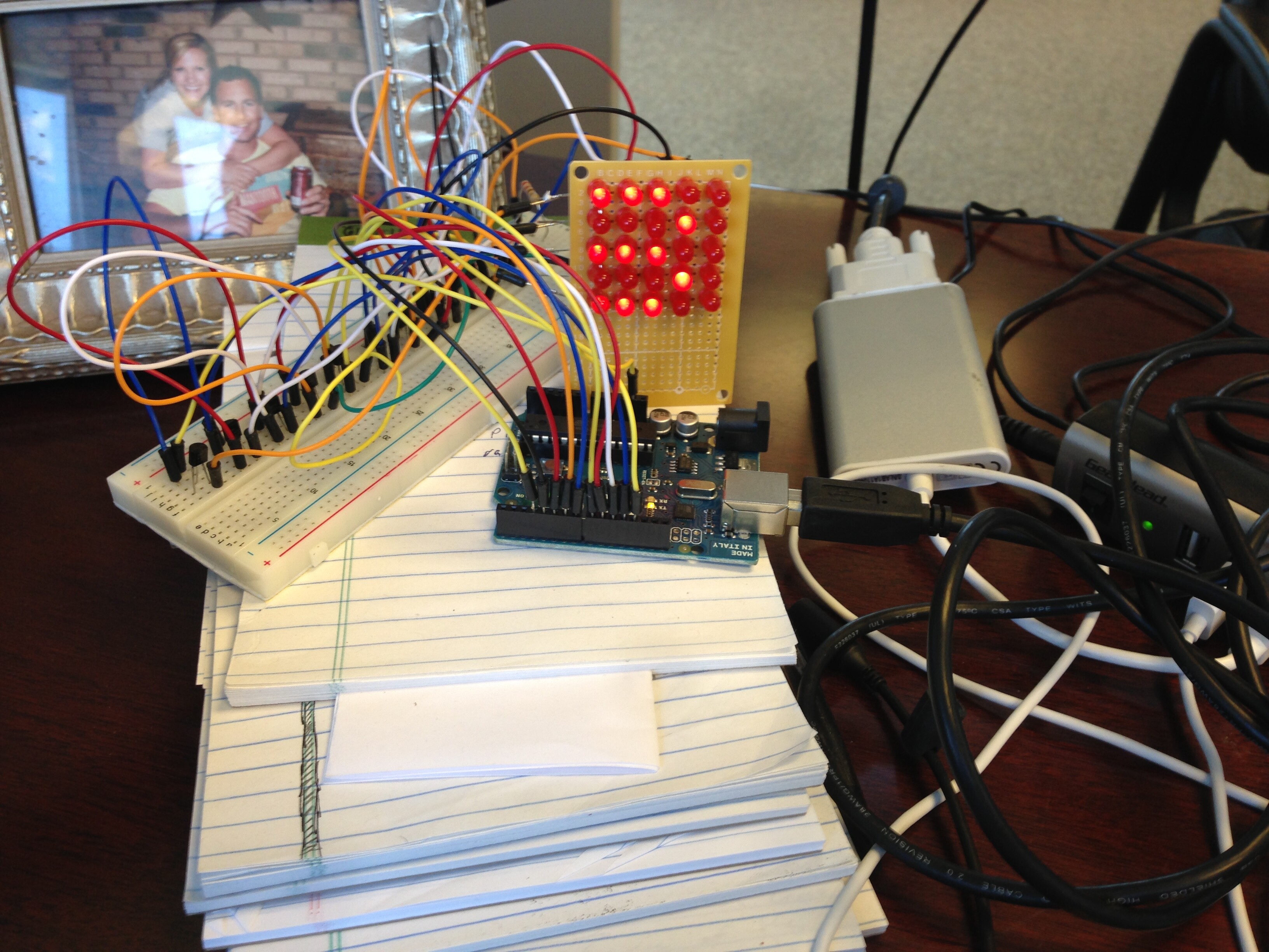

5x5 LED Matrix Limited to 5 characters
How can I enable the string_map to handle more than 5 characters. My ultimate goal is to put in a complete sentence with spaces. Any help is appreciated.

Try this:
//5x5 SCROLLING LED MATRIX
//16 JUN 2013
//Font Matrix @ http://arduino.cc/forum/index.php/topic,7384.0.html
const char Message[] = "robyn";
const int CharacterCount = sizeof Message - 1; // Don't count the terminating null

boolean string_map[5][5*CharacterCount];

  string_map_max_col = 5 * CharacterCount;
  create_string_map(Message);

Thanks John for the quick response. Can't wait to try it out. Had to jump on a flight but will try it shortly
ok - well I got a chance to try it out and it works fine with 5 characters example "robyn" but if I put in "robynn" six characters all the LED's just light up and the same time and stay on. Do I need to add frame buffers? Does that affect the timers? Lots of questions. Sorry
