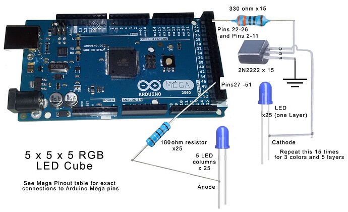

5x5x5 RGB led cube
5x5x5 RGB Color Cube

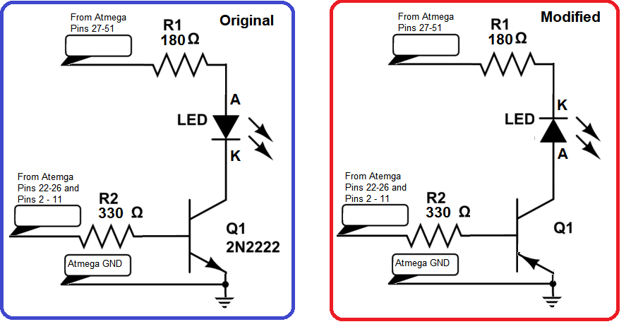

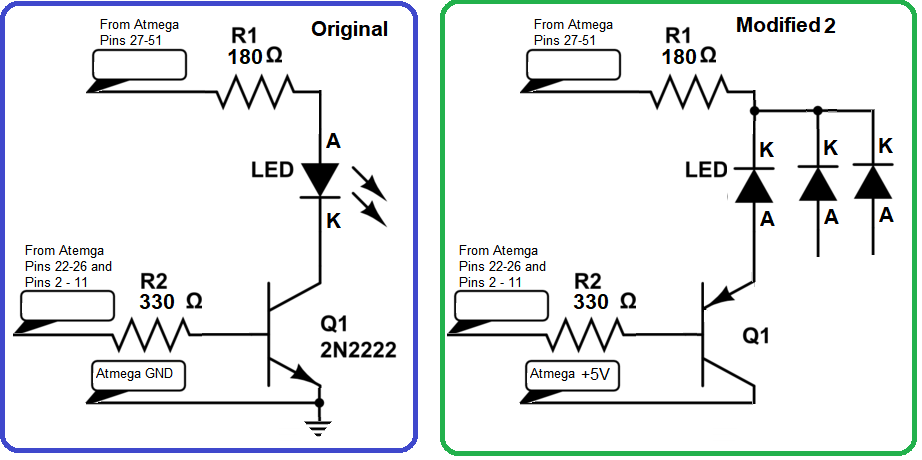

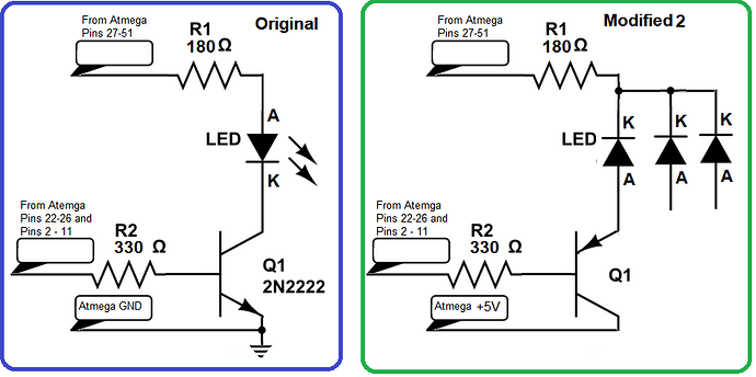

That is the how to i followed with some changes.
I have used not common anode leds but common cathode leds.
And not NPN transistors but PNP transistors.
I have the problem after some coding changes (common anode to cathode) that all the leds are on during the loop and they must be off.
in the following code there should only be one led on and the rest off

// *********************************Setup ******************************
    // set all pins to output and initialize low
    for (int x = 2; x < 12; x++) { // Green and Blue anode pins
        pinMode(x, OUTPUT);
        digitalWrite(x, HIGH); // Common Cathode: Change to HIGH
    for (int x = 22; x < 52; x++) { // Red anode (22-26) and Cathode pins
        pinMode(x, OUTPUT);

// turn on red LEDs for BAMtime (common cathode)
void redCathodes(int mytime) {
  configAnodes(0, 0);
  PORTH &= ~(1 << PORTH4);
  delayMicroseconds(mytime);
  PORTH |= (1 << PORTH4);

Post your project schematic.
It is the same schematic as shown on the site
Schematic
Only i used PNP transistors instead of NPN because the common cathode.
And the pinout connections
Pinouts from the mega to cube
What the author of this link called schematic is anything but schematic.
As the author believes he has the right to modify concepts and not care about technical standards, the question remains. Does the project also obey the fundamental rule of “working”?
Anyway, this is not a schematic anywhere in the world.
Schematic for 5x5x5 RGB LED Cube

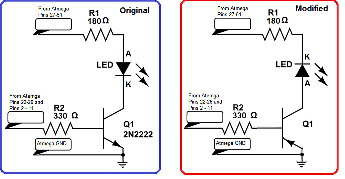

This is your modified circuit? (Inside red ).
Let us hope not. The LED in the red box will never illuminate.
Pleas post a part number for your LEDs.
As @ruilviana says, regular LEDs aren't common cathode or common anode.
Did you maybe wire the hole thing with every LED backwards, and now you try to compensate for that by switching transistors and fixing the code?
Except for the differences. Post a schematic of what you actually have in front of you, not words about how to modify a non-schematic to make a non-schematic for ourselves.
a7
It is indeed the red schematic.
I use as q1 a BC327 and the emiter is connected to 5v positive, and not to ground, otherwise it would not work as you described.
It is a weird way of building a schematic, but it works for me.

Despite knowing this modified circuit wouldn't work, I posted it so the OP would realize how a lack of information can cause confusion in trying to help.
If you notice, I didn't use any special software to draw this scheme of your project, but rather I used a simple
"paintbrush".
But there are great free offline and online programs for drawing schematics.
Ex: Offline:Kicad: Download | KiCad EDA
Online EasyEda: https://easyeda.com/
" As the ancient Egyptians said: :rofl: :rofl: :rofl: :rofl: :rofl: "
A drawing speaks more than a thousand words.
In the original circuit, the LED will light up when pins 27-51 are HIGH and pins 2-11 and 22-26 are also HIGH.
With modified circuit 2, the LED will light up when pins 27-51 are LOW and pins 2-11 and 22-26 are HIGH.
The way the code is written, the LEDs will be on when they should be off and off when they should be on.

I know what you mean with the led in red box, like that it will never illuminate because of the gnd connection.
What i said earlier, i have connected the emitter of the BC327 to the positive 5v side, so the leds are illuminating, all at once at the color white.
Only with this test code there should only be one led be active and not all.
The test code works, and the leds are working properly.
The code sets all the leds leds on, where they should be off.
Only the active leds must be on.
The color change of the leds are working properly.
If you think that I have connected my leds wrong, how do you think it should be.
In the modified 2 section you placed the q1 with the emitter towards the leds anode that is not how i connected my leds.
That is the way i connected my leds
15 transistors in total.
3 X 5 for each color and layer.
is there a way to invert that coding

  if ((cube[0][2][layer][color] & mask) > 0) PORTL |= (1 << PORTL7); else PORTL &= ~(1 << PORTL7); // pin 42
If you reverse the logic of every if statement, LEDs will illuminate in exact opposition to how they operate now. This was your expressed observation.
  if ((cube[0][2][layer][color] & mask) == 0) PORTL |= (1 << PORTL7); else PORTL &= ~(1 << PORTL7); // pin 42
Test for it being zero instead of it being not zero.
Tell us what happens when you dry that.
a7
it works, Thanks a lot!!!
