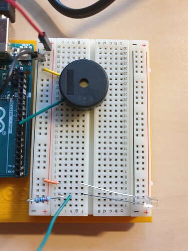

like the topic indicate, I am working on the Arduino Starter Kit project "Light Theremin". Learning from here should be: Using a phototransistor and a Piezo. So, I am going to make a light-based theremin/tone.
Please note: I am till beginner. All the parts I have wired up are provided by the Kit. I do have DMM.
Status quo: I have wired all up, and upload the code. No coding errors occurred.
Issue: After I have plugged in/power on the Arduino and the 5 sec celibate window is over, a constant, steady, and high peep tone appeared. No regulation, no stop what's however via the phototransistor.
Interesting so: If I swap the phototransistor with Potentiometer, everything's goes after plan. I can stir the tone, like in project purpose.
Interesting so: If I hook of the A0 wired connection, the tone disappear and just strange sound like almost R2D2 but no tone calibration.
Here the schematic of the circuit from the book.
Here my wired up circuit.
If requested, I would try to do skatch from my schematic.

Is the photo-transistor a photo-transistor?
Also, is it wired up correctly?
It sounds like the code is working correctly and the wiring sounds correct, the problem most likely is with the photo-transistor.

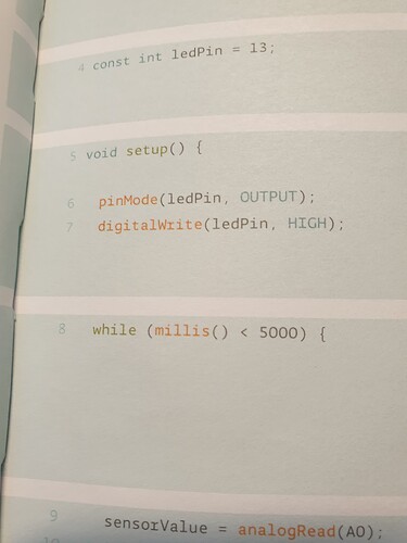

Imma bet this
  while (millis() > 5000) {
should be
  while (millis() < 5000) {
and that for the first 5 seconds you are supposed to be training the sensor by moving it back and forth between the extremes of light and dark you expect to see and want to react to.

Can you make a pic with the side of the phototransistor visible?
That would allow us to be sure that it is wired in the correct direction...
Good catch. It wouldn't calibrate with this error.
I'm curious if the project book has this error.
Hi @theeccentricgenius thank you for thought.
I agree with your post. Yes, I guess so. Long leg, Anode, 5V, power.

Sorry @2112 the book was/is right. This time it was my round to do the trouble. :joy:
