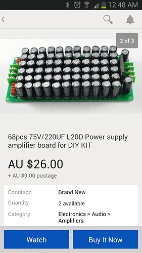

See the attached photo...
This to me looks like a way of selling unused stock, anyone happen to know if there's any benefit to using this method ie 60 small caps vs several large capacitors instead? Except less soldering that is...
In theory, lower ESR and higher ripple current rating.
However, being that it's advertised for audio use, the primary purpose is to give audiophiles something to be excited about. "Look! Instead of one capacitor, I use 60! You should hear the improvement in spaciousness, tighter low-end, and effortless highs!"
Perhaps a lower ESR can also be achieved with just a single better quality capacitor. That might be more expensive than 60 dirt-cheap capacitors. There might be something there, it is a low ESR for a low price.
However, 60 capacitors means 60 times more chance for a leaking capacitor.
... Now that I gave it a second thought: It's completely nonsense.

I see 68 capacitors on it. But, maybe larger caps would be too tall for the space it is to fit in.
