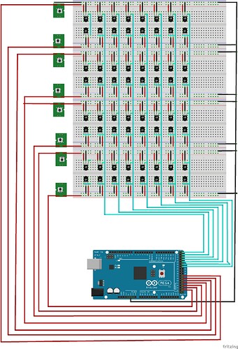

My need is to control 64 A3144 hall sensors positioned in a row and in a column.
The A3144 has a VCD, GND and 1 digital pin.
Each sensor must return to me the magnetism of a magnet and whether or not it is active.
For this, I do not want to use 64 I/O which would require a system with a multiplexer.
My need supports a slight latency time, the wiring principle is that in the photo as well as the fritzing file. It does not respect the test plate except for the red and black power supply...
a) Each line has its own power supply which is powered by the push of the button.
So the hall sensor lines only need 8 pins to turn them on and not 64
b) the lines are powered each in turn. I cannot have more than 1 active line.
c) The digital is connected by column thus reducing the I/O from 64 to 8.
THE PRINCIPLE
When I activate line A with the button, I can determine which of the 8 halls of the line has an active magnet or not. If I did it manually with each of the 8 buttons, it would be possible for me to know the status of the 64 halls
QUESTION AND NEEDS
1°/ I do not want to do it by button but by a code loop which will check each hall coded according to its box
Should I directly connect the red of each line on the card or should I put some kind of power supply in the form of MOSFETs or transistors to quickly turn on the hall sensors of the line? What to wear?
2°/ The digital pin being connected in parallel by column but only waiting for the return of the powered line... to ensure the integrity of the signals should I add a capacitor to filter? If so, what kind ?
3°/ Do you have examples of codes allowing you to make the power supply loop for each line and retrieve the status of each hall in a simple and efficient way to have the variable status of the 64 hall sensors in an infinite loop?
Thank you for your constructive feedback and clear answers.

One problem I can see is that the operating current for each sensor is typically 4.4mA but can be as high as 9mA. With 8 of the sensors powered together, that could be between 35mA and 72mA, which is too much for an Arduino pin. So some high-side drivers will be needed to replace the buttons.
Some pnp transistors such as BC327 might work as high-side drivers. Don't forget current limiting resistors between the pnp base and Arduino pin, e.g. 4K7. The pnp will have the effect of inverting the Arduino output pin, so in your code you will need to set all the pins HIGH and change one pin at a time to LOW to power the row of sensors.
You may also need to pause for some time between powering a row of sensors and reading the outputs. They are probably not designed to work with intermittent power and may need time to settle after power is applied. The data sheet may have some figures on this.

With shift registers, you would need 8 of them, which can be daisy chained to the same 3 arduino pins. All sensors would be powered full time.
With matrix approach, only 8 sensors at a time would be powered, and your code would power each row in turn, as you have been showing with your buttons. But it may be neccessary to pause for a short time between powering up a row and taking the readings, because the sensors may need time to settle after power is applied.
I recommend you make a prototype with 4 sensors (2 rows, 2 columns) and test that. For this prototype, you will not need the pnp transistors.

My personal preference is: use the least number of components. The Mega has enough in- and outputs for 64 (or 192) sensors.
One resistor plus one transistor per row is inevitable (mind to make only one output low at a time). The open collectors will work fine with the internal pullup resistors of the inputs. Filtering the signals will not be necessary in the shown small setup.
I would write an ISR on TIMER2_OVF that reads the inputs and then switches to the next row. The standard set up of the Arduino IDE makes that timer overflow once per millisecond, which gives the sensors enough time to settle, and doesn’t block the rest of the program.
The Mega has the same voltage regulator as the UNO R3. Worst case scenario: when powered with 12 Volts and the calculated 72mA drawn from the 5V pin, the heat dissipation of the regulator will be considerable, but probably not too high, especially on the workbench with free airflow. When powered with a lower voltage or from USB: no problem.

Remark 1: are you aware that with the MCP23017’s you’ll need pullup resistors (64 66)?
Remark 2: start writing the communication program to set them up and to read them. Compare that to:
// hall sensors A3144 8 x 8 bitfield
// rows are addressed by PA0..PA7
// signals from columns to PC0..PC7
volatile uint8_t bitField[8];  // create the bitfield
ISR(TIMER2_OVF_vect) {                 // refreshes the bitfield in 8ms
  static uint8_t rowCounter;           // local variable, remembered next time
  bitField[rowCounter] = PORTC;        // move all 8 columns to the bitfield
  rowCounter++;                        // advance row counter
  if (rowCounter > 7) rowCounter = 0;  // last row
  PORTA = 0xFF;                        // switch off all rows
  PORTA = ~(1 << rowCounter);          // make one row output low
  PORTA = 0xFF;     // set row outputs high before making them outputs
  DDRA = 0xFF;      // make them outputs
  PORTC = 0xFF;     // switch on the pullups for the inputs
  TIMSK2 |= TOIE2;  // enable overflow interrupt timer2, doesn't interfere with the PWM signals
The I/O's are not exactly according the drawing in the fiirst post, but quite close.

100k is somewhat weaker than the AVR processors, but should be enough.
This reduces the number of components to: 4 chips and 2 resistors, against 8 resistors and 8 transistors in my proposal.
Leaves the software.
By the way: worst case for supply is now 64 x 9mA = 576 mA, more than USB-standard.
You might get lucky, not all of them pull max current.
Please elaborate.
With the expander: 4 chips, 2 resistors and 2 i/o pins, which are usable as I2C otherwise.
With the multiplexer, 4 chips or modules, 1 resistor and 9 i/o pins.
Where comes 8 resistors and 8 transistors? If you need to turn off rows of sensors, don't you need to do that no matter which way you collect the 64 sesnor outputs?
@beback did I miss an answer to the questions - why do you need to turn off the sensors, and have you looked into whether they will power up rapidly and supply meaningful output at the rates you intend to scan and collect their outputs?
