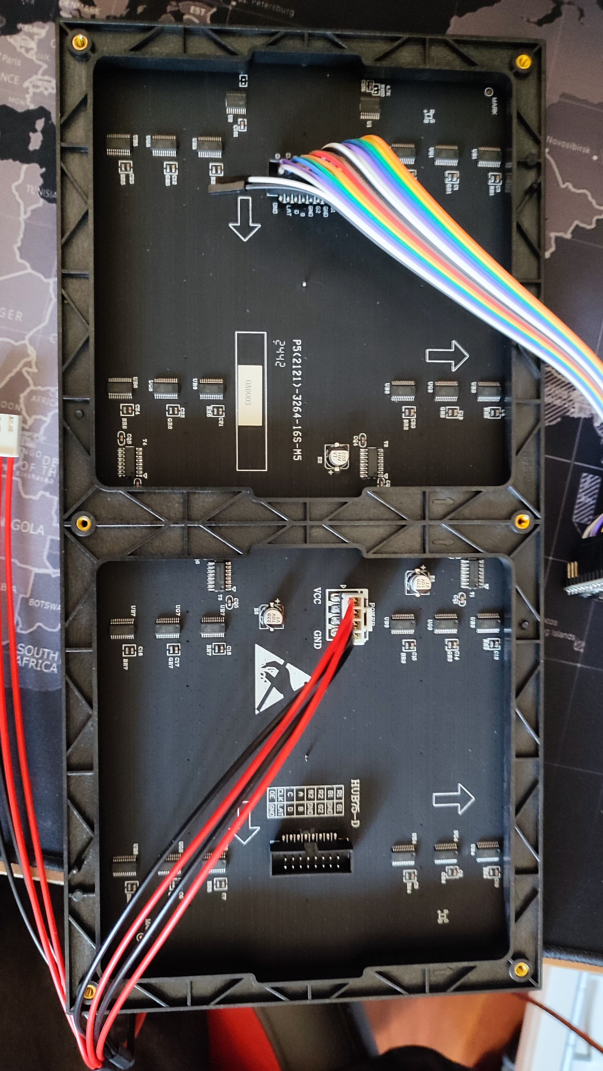

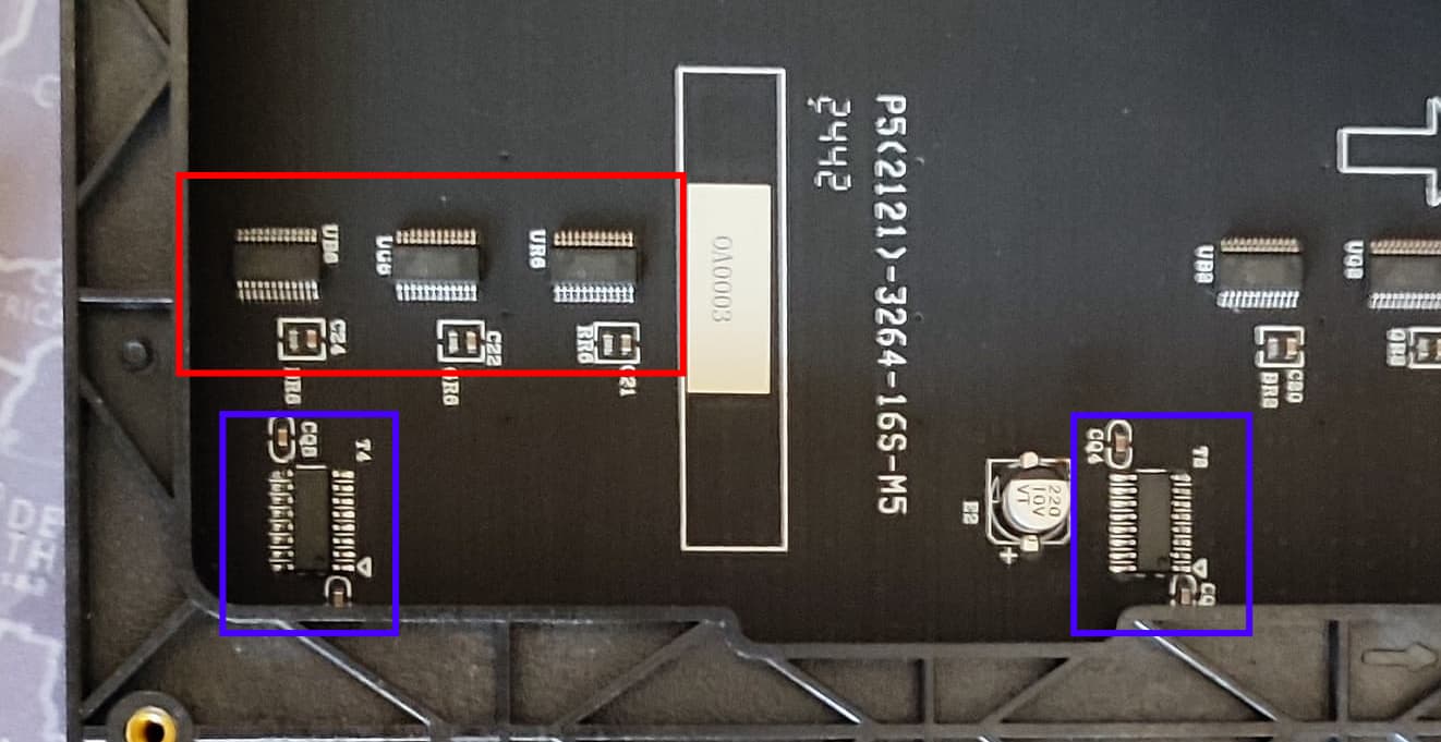

Hello everyone,

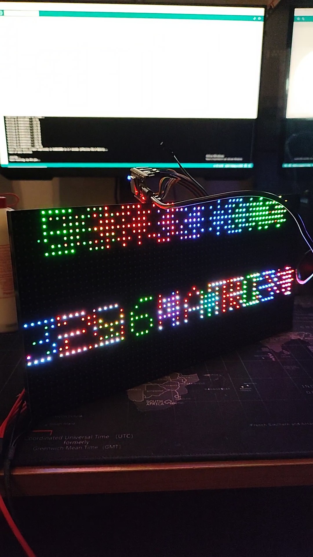

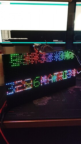

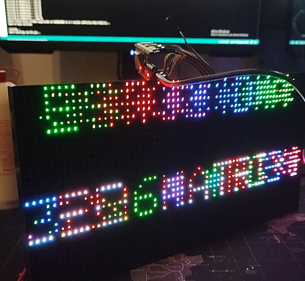

Today I tried using the 64x32 led matrix for the first time, I found this test code online, but even connecting everything correctly I found this issue: Only the first and the third sections of the panel light up, overlapping what should be in the other two sections (video attached). This is the code, what might be the issue?
