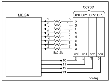

7 segment 4 digit blinking
Hey
when the 7 seg show number 10 is blinking
someone can help me ?
thanks

https://create.arduino.cc/projecthub/Hack-star-Arduino/learn-arduino-port-manipulation-2022-wokwi-systems-simulat-10f9af
i didnt understand anything from this sadly
Hello
Avoid the ussage of the delay() function.
Take a view to gain the knowledge.
Дайте миру шанс!
@orrarduino
1. I would like to suggest that you drive 4-digit cc-type 7-segmeny display unit (Fig-1) using SevSeg.h Library. As a result, a lot of codes from your sketch relating to 7-segment display would be eliminated. The resulting sketch is given in Step-2.
cc4Rq
Figure-1:
2. Revised Sketch (compiled but not tested)

  byte segDPins[] = {2, 3, 4, 5, 6, 7, 8, 9};  //DPin-2 = seg-a, …, DPin-9 = seg-p
  byte ccDPins[] = {10, 11, 12, 13};          //DPin-10 = cc0, DPin-11 = cc1, .....
  sevSeg.begin(COMMON_CATHODE, 4, ccDPins, segDPins, false, false, false, true);

3. The SevSeg.h Library contains the following functions and declarations to drive multiplexed 7-segment display unit.
(1) sevSeg.begin(arg1, arg2, arg3, arg4, arg5, arg6, arg7, arg8);
sevSeg.begin(displayType, numOfDigits, ccDPins, segDPins, softCurrentLimitResistor, updateWithDelays, allowLeadingZeros, disableDecPoint);
arg1= Display type :
Value = COMMON_CATHODE or COMMON_ANODE.
When COMMOM_CATHODE is selected, the program automatically consults digit-vs-ccCode LUT Table of the library to collect the ccCodes for the digits to be shown on display unit.
arg2 = Number of digits to be shown: Value = 1 to 8
arg3 = an array that contains DPins with which the cc-pins of the digits are to be connected
arg4 = an array that contains DPins with which the segments-pins of the digits are to be connected
arg5 = SoftcurrentLimitResistor (Software controlled): Value = true or false
true means software controlled current limit resistor;
false means that the current limiting resistors are installed manually.
arg6 = updateWithDelays : true or false (choose false; why? No idea.)
arg7 = allowLeadingZeros : Value = true or false;
true means keep the leading zeroes like: 05
arg8 = disableDecPoint : Value = true or false;
false means that we can show decimal point at any position of the display unit. The position is determined by sevseg.SetNumber() function.
===> sevseg.begin(COMMON_CATHODE, 2, ccDPins, segDPins, false, false, false, true);
