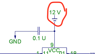

I am building an arcade game that needs to display time remaining (2 digits); score (3 digits); and high score (3 digits). I plan on using Sev.Seg library the programming for which I understand pretty well how to split one 8-digit number into three distinct numbers. However, I am struggling with the wiring schematic because I need to use a 7.2V power supply to illuminate a total of 8 individual LED seven-segment displays. The schematic that I have in mind looks like this:

Are there any concerns about this wiring schematic? If so can you make suggestions?
Yes I can't see remotely how this would work. It is beyond a single suggestion it is simply just wrong.
No base resistors on any of the transistors, lots of displays being powered through a single resistor. Switching voltages wrong, no obvious way that they are multiplexing. No sensible power supplies, or decoupling.

Thank you. I can now see the many faults in this circuit. I will rework it using Jim's suggestion (using Mosfets) and share my circuit again.
Ok, thanks to the circuit lessons provided by @Grumpy_Mike, kolaha, and @jim-p, I have revised my proposed circuit as follows:
How does this look?
Do not use a ground symbol for the power input, it is not what the rest of the world does and it is most disturbing.
Ground
Next why feed the TBD62783A with12 Volts? I thought your 7 segment displays needed 7.2V and with the circuit you have you will get 12V outputs from this chip. If you want 7.2V out you must feed it with 7.2V input not 12V.
You can't use the 240R resistors to cut down the voltage, because as I said before the voltage drop will depend on how many segments will be on. So you need to supply the right voltage. Also you didn't post a link to these displays so we can't tell if they have any internal current limit. So forget the 240R resistors and feed the displays with what they are asking for.
Also check the data sheet for these two chips to see if you will be exceeding the maximum power dissipation for the chip.

Every driver chip needs a 0.1uF ceramic capacitor between power and ground.

@Grumpy_Mike here is the circuit redrawn with what i understood your suggestions:

Check again. I think that is the absolute rating, not the working rating. An absolute rating is the point where damage starts to happen. At the absolute rating it will not always work.
Well you still have the resistors in the driver.
Do you know there are two ways of driving the multiplexing, and depending on which way you choose could affect some of the circuit?
