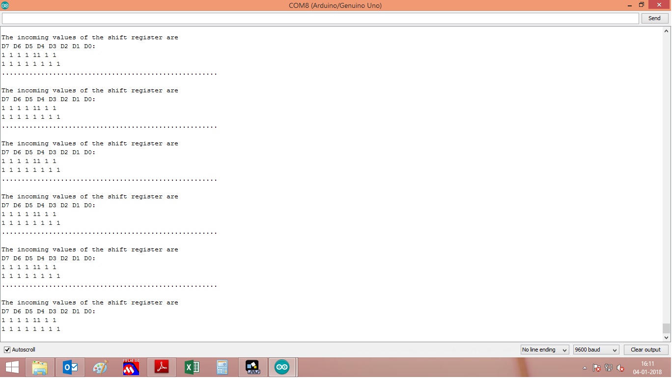

I have used below schmatic , In place of DIP switch i used push button.
I am trying to give random push button input. For some input it working fine.

if i give same input in combination the waveform wont get reflected as expected, for example if push button for D6D7D8 are pressed output QH remains LOW.
My intention is what ever switch pressed must be detected and give proper Serial out.
and also How can i read the Q0-Q8 values to convert it to Integer. I am planned to read those data to caluclate value 2^8. based on Input switch pressed equivalent value should be printed.

      incoming = read_shift_regs(); // Read the shift r egister , it likes that
      Serial.println("\nThe incoming values of the shift register are ");
      Serial.println("D7 D6 D5 D4 D3 D2 D1 D0:");
      print_byte(incoming); // print ever y 1 and 0 that cor r elates with 8 thr ough 1 of the dip switch
      delay(1000); // Wait for some ar bitr ar y amount of time
      Serial.println(".......................................................");

I have given input as per datasheet the waveform i am getting not matches the out put.
Input given as per datasheet refer page no 12:
CIrcuit i designed for testing
I have attached output for above code . kindly let me how exactly i can create as per datasheet waveform
channels.txt (3.18 KB)
I have tested above code . Its not even generating clock pulse.

I have tested below code and its working fine . Only clock is out of syn
@Tom i have tested code if i am giving input as per datasheet the Serial out shown in attache image

Yes or No, DID YOU TRY THE CODE I POSTED In POST #16?
Please post JUST that codes output.
Tom... :slight_smile:
Yes i have tested the code . Its not working. It wont genrate clock pulse. I have pasted Serial output in code1.jpg.
