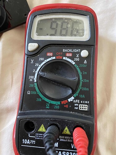

Now I got the PCB and couldn't figure out why my leds are not working, tried to measured the voltage that the shift registers output and got very small voltage (less then 1 volt I think).
My leds cathode were connected to teensy ground and their anode to the shift register outputs.
I tried to connect the cathode of the leds to the shift register output (and the anode to Teensy VCC) and the leds are working (as expected) when the 74HC595 is set to Digital LOW.
When trying the measure the voltage when the shift register is set to HIGH I got almost 1v (picture attached).
Where were the meter probes attached? What color LEDs?
What does the same output measure when set to LOW?
Also put your DMM on AC volts and measure the output voltage.
I assume you do not have a oscilloscope to see if your output is in fact high frequency pulsing.

Now I must confess that I tend to leave the protective plastic on my LCD screens, but I think it might just be time to remove it from that multimeter. :grinning:
