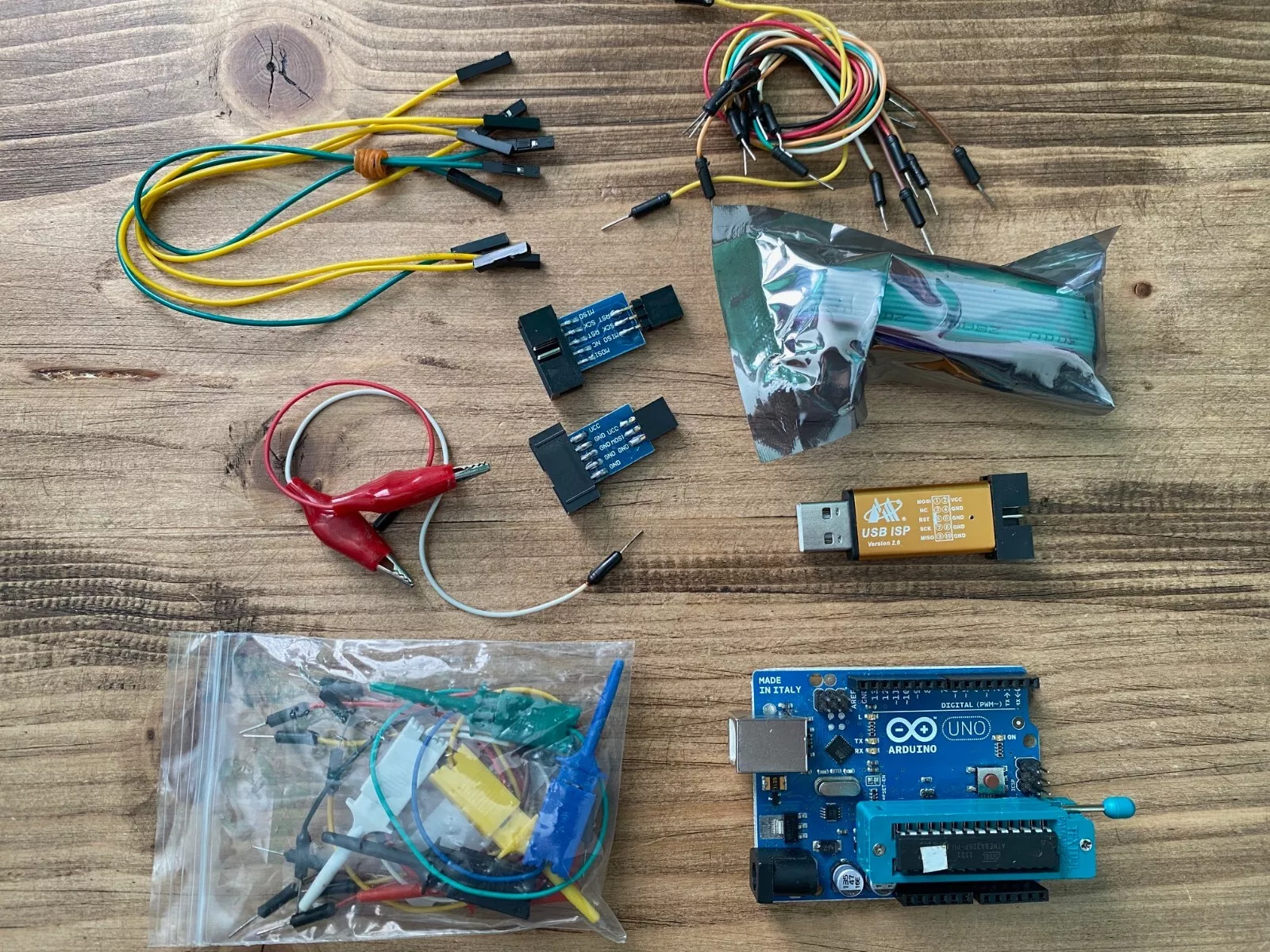

So, I feel i am way in over my head here but i am going to give it a try anyway. I want to create a 74S288 / 82S123 PROM programmer as i have a few arcade boards and nothing which can write these PROMS.
I have seen this can be done: Click for project
Only issue is, I am a complete newbie to all this stuff. I have a technical background but nothing to do with this yet.
I just got myself an Arduino with some extras
I've also purchased most of the components needed for the board.
Is anyone able to help me better understand all this? I know I'm jumping in the deep end but i only really learn when theres an actual end goal which i need.
Thank you

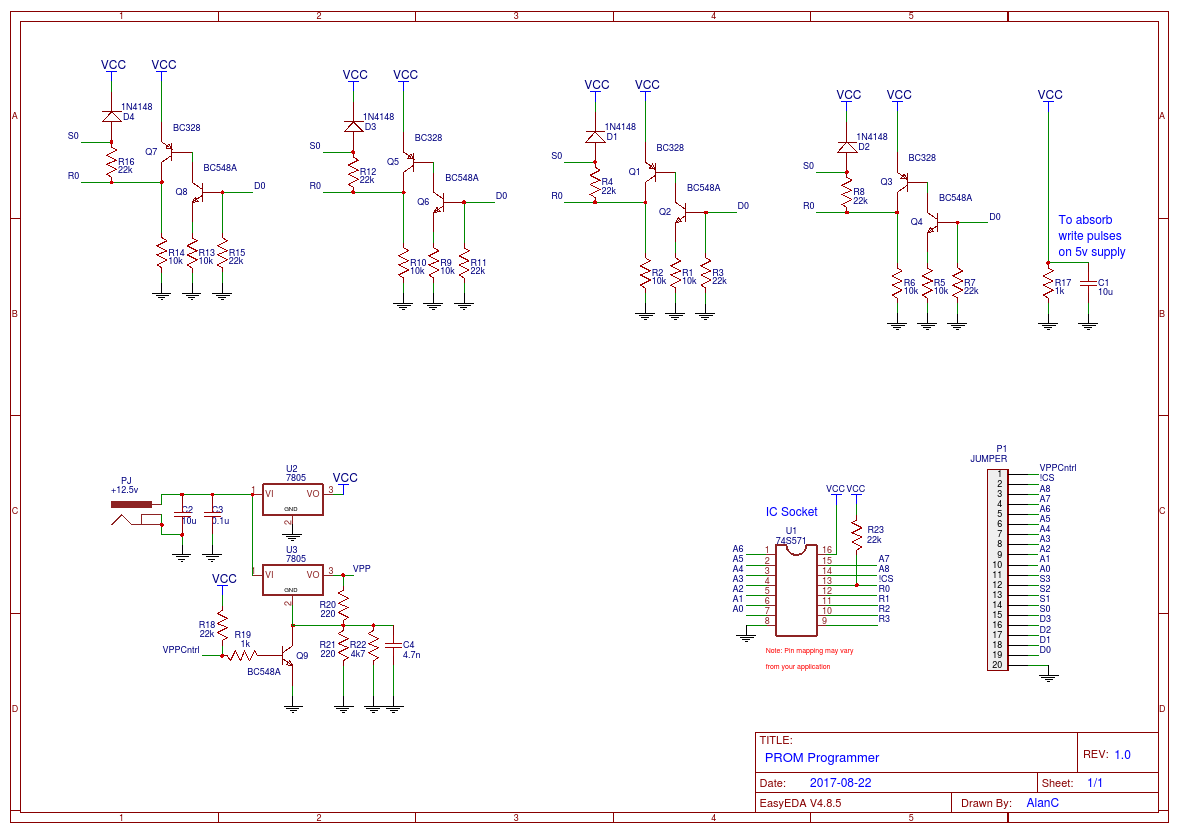

Can You extract code, schematics and datasheet links and post them here?

Some thoughts:
The project you linked to is in no way a beginner's project.
First, it is for a 512x4 bit PROM (74S571). The 74S288 is 256x8. So the Uno won't have enough I/O pins by itself to program a full byte.
(A quick look through my 1977 NatSemi Memory Databook indicates that they program in the same fashion.)
Second, the sketch is... minimal doesn't begin to describe it. It's a one off program designed to program a fixed pattern of nibbles. It's more of an example than anything else.
An experienced person with coding and hardware design experience would be able to use the schematic and code as a basis to build on to create a useful programmer. It would not however be something they'd knock out in an evening. And having made my own EPROM programmer for fun and education, I feel I speak with some experience on the subject.
And no, I'm not offering to tutor. Just pointing out that you have a lot of learning and work ahead of you.

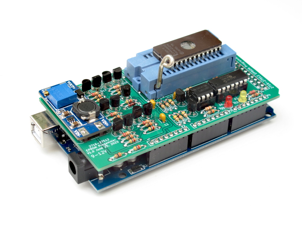

Here's guy who has apparently done this:
https://www.youtube.com/watch?v=mj218WpNHEA
Back in the day, I built a programmer for the 40-pin 82S100 so as to get replacements for the Commodore C64's PLA chip. That turned out to be a largely manual process, and included high voltage drives.
But the 82S123 is much smaller. You have 32 bytes. Five address lines, and eight data lines. So even less fancy than in the video, you could set up DIP switches on these lines, set them manually one address at a time, and press a button to burn the data. Thirty-two bytes wouldn't take all that long.
But it should be possible to automate the process with an Arduino driving two shift registers and a transistor circuit for the high voltage (if any is needed). The first step is to find out exactly what the programming process is - the timing, the polarity, the voltage, etc., which will probably not be in the datasheet.
The downside is that these chips can't be reprogrammed. So when you need to make a change, you have to burn a new chip. And I suspect they aren't cheap. The alternative is to find an active EPROM or EEPROM part that could replace the 82S123, but which no doubt will have a completely different pinout, and make a daughterboard for it that would plug into your arcade. Then you could program the EEPROM from an Arduino. But I don't know how easy it would be to find full parallel addressed EEPROMs these days.
[82S123 bi-polar PROM replacement kit (82S123-to-27512)]
(82S123 bi-polar PROM replacement kit (82S123-to-27512))
