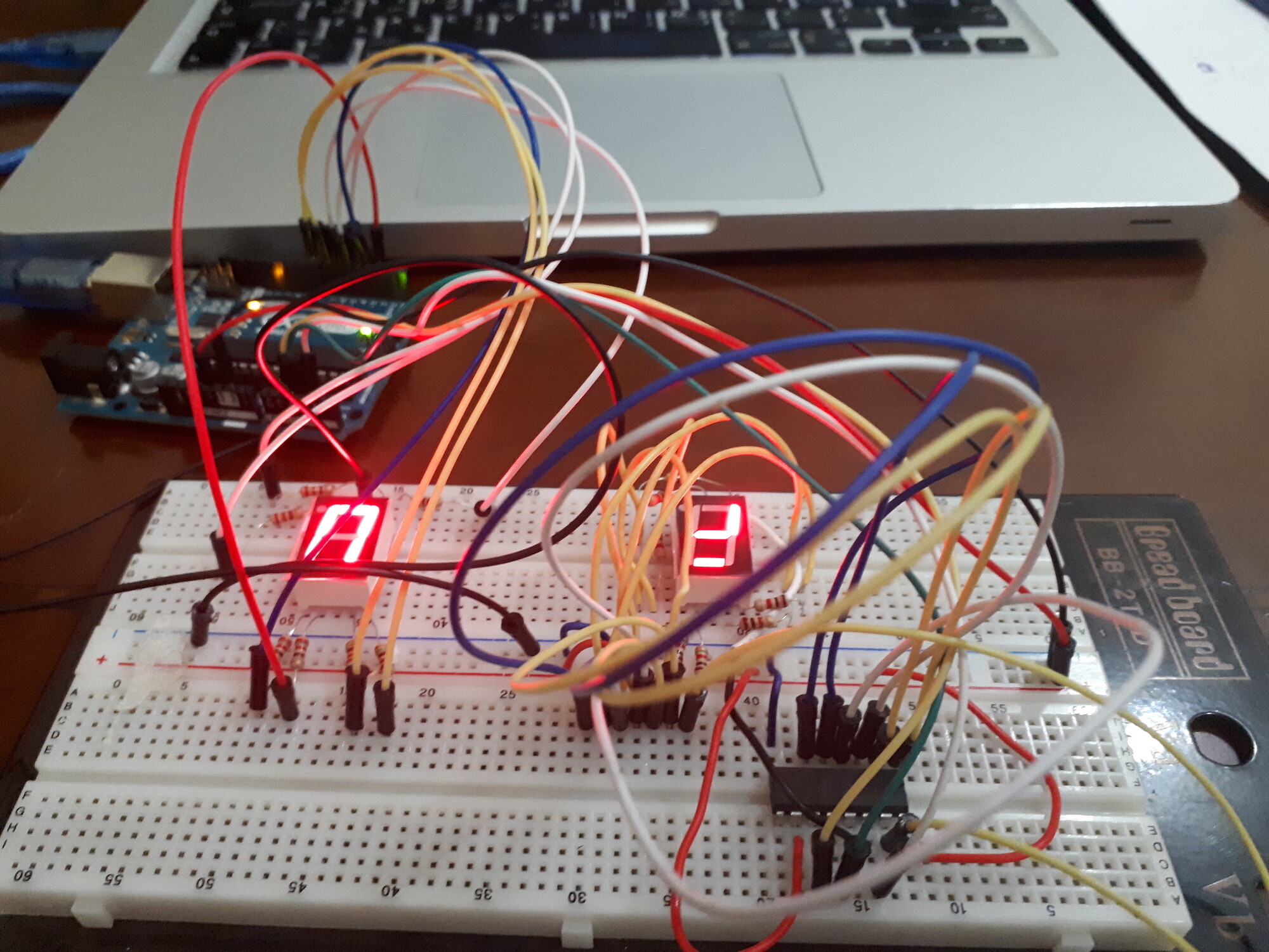

Good evening,
I need to control 7segment display with 74hc595 IC.
I tested the code with 7 LEDs and 74hc595 IC, it's working correctly.
I tested the 7segments directly connected to Arduino and it's working correctly.
When I integrate the shift register and the the 7 segments, three segments are continuously ON regardless of the value of the shift register.
I am using 8 10k resistors for the LEDs segments,
when I checked some videos online, I saw that they are using only one resistor ?
how to proceed ?

I attached image of the circuit.
Is your end result just to display a count down on one digit? Or is there a more involved project going on here that we don't know about? I have been working on a project involving segment displays and might be able to help if I knew exactly what you were trying to end up with as a final result. The picture is hard to make out the exact schematic.
In the code, I am trying to test the connection only.
I keep changing the number to display, but the same three segments are always ON.
Later, on I want to display a value from a keypad on the seven segments.

I tried the code, but I got the same result.
Only segments a,g, and e are ON
I tried two combination numbers.

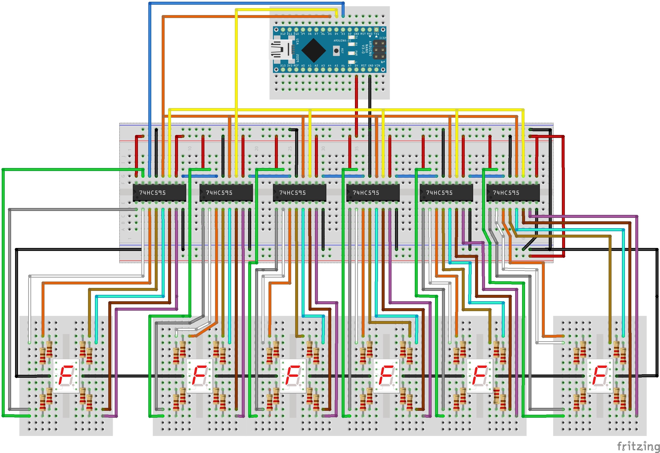

Schematic
Here is a link for the schematic I posted on another thread I am working on right now. Keep in mind this schematic will differ from your model segment display, but the pin connection to the shift register should be the same. This is shifting out to multiple displays, but the only difference is the Q7 on the 1st register goes to the Data Pin on the second which you won't need. Hope this helps.
If you get the same result on both your code and Waldo's code, then you probably have the wiring wrong somewhere. It's not possible to tell much from your picture.
But as for the resistors, I see a lot of people connecting LEDs and 7-segment displays without resistors, and it may work, but in most cases it's just wrong. If you are displaying all seven or eight segments at the same time, then you need individual resistors on the segment lines so that all the segments that are turned on will be equally bright whether you are displaying "8" or "1". There are legitimate ways to avoid this, such as multiplexing by segment instead of by digit, but for what you are doing with the 595, I think you should continue to use your resistors.
