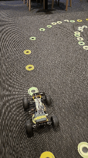

I have an RC car that controls the drive motor with what I assume is an 8.4V PWM signal. I want to capture that signal using an Arduino (Typically I use the PortentaH7 but have lots of other alternatives) so I have the option of RC fallback when my Arduino controlled car does not do what it should.
Anyone go a quick and easy way to reduce that voltage to something acceptable to be read by the Arduino. I assume, I should use some kind of a voltage divider but not really sure how to connect it. Also, anyone got ideas on how to do the actual reading? Once again I can just try stuff until something works, but better if someone actually knows what they are doing.
The car is actually doing some cool vision Machine Learning self-driving, but I want the RC controller as a backup when things go bad. Any suggestions or wiring diagrams would be appreciated.

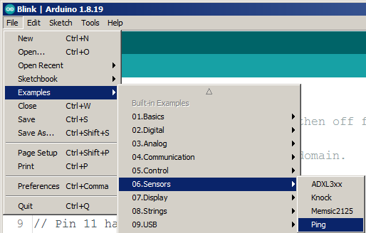

@kolaha I am used to using pulseIn() for the rangefinder that has a trigger and then an echo pin. I was wondering how to use it for PWM on one wire. That code uses only one pin more like what I need to do.
Thanks!
there is 2 types of ultrasonic rangefinder modules - 3 and 4 pin. i have seen sketches for both.
in yours case you don't need to generate US pulse before running pulseIn().

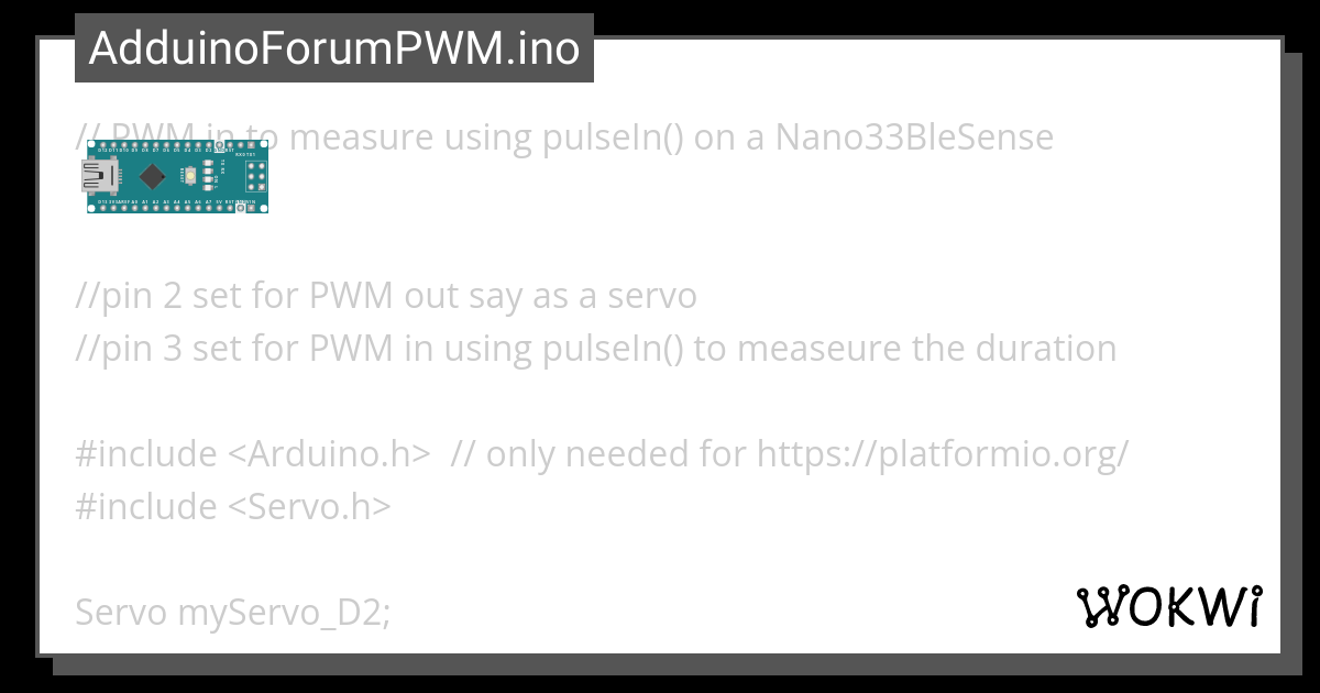

So here is my code for the Nano33BleSense just using generated PWM not the external PWM yet.
// PWM in to measure using pulseIn() on a Nano33BleSense
//pin 2 set for PWM out say as a servo
//pin 3 set for PWM in using pulseIn() to measeure the duration
#include <Arduino.h>  // only needed for https://platformio.org/
#include <Servo.h>
Servo myServo_D2;
int myDelayBig = 3000;   // non-block delay in milliseconds
unsigned long myStartBig;
int myDelaySmall = 1000;   // non-block delay in milliseconds
unsigned long myStartSmall;
// this constant won't change. It's the pin number of the sensor's output:
const int pwmPin = 2;   // D2 near GND on right side
const int pingPin = 3;  // D3
int myPWM = 0;   //0-255
unsigned long myPulseDuration = 0;
  myServo_D2.attach(2);   // D2 should do PWM on Nano33BleSense
  myStartBig = millis();   // set delay
  myStartSmall = millis();
  pinMode(LED_BUILTIN, OUTPUT);
  long myDuration;
  if ( (millis() - myStartBig ) >= myDelayBig) {
    myStartBig = millis();           //  reset the delay time
    myPWM = random(0, 255);       // 0-255
    if (myPWM <= 50){myPWM = 0;}     // test zero
    if (myPWM >= 230){myPWM = 255;}  // test full on
    myServo_D2.write(myPWM);
    Serial.println();
    Serial.println("The PWM has been set to: "+ String(myPWM) + " for "+ String(myDelayBig) + " milliseconds.");
  if ( (millis() - myStartSmall ) >= myDelaySmall) {
    pinMode(pingPin, OUTPUT);
    digitalWrite(pingPin, LOW);
    delayMicroseconds(2);
    digitalWrite(pingPin, HIGH);
    delayMicroseconds(5);
    pinMode(pingPin, INPUT);
    myDuration = pulseIn(pingPin, HIGH);
    Serial.println("The PWM is measured at: "+ String(myDuration) + ", a reading every "+ String(myDelaySmall) + " milliseconds.");
And here is the very useable output. I could use some equation to convert it to PWM estimates but I don't really need that. I had no problem with either the high or low values. Not really sure why.
Next I need to test the real 8.4 V PWM That may be at a different frequency.

Your code is generating the PWM signal using Servo.write(). This may not be representative of the external PWM signal you want to measure.
Servo control signals are a specific type of PWM signal. The frequency is low, usually around 50Hz. The pulse widths are normally between 1ms and 2ms. So the duty cycle varies in a narrow range between around 5% and 10%. You never get the problem I described at 0% and 100%. A circuit inside the servo motor measures the pulse length and moves the motor to a corresponding position. It does not care too much about the frequency, or the duty cycle, only the pulse length, so if the frequency was 25Hz or 100Hz it would still work correctly.
The type of PWM signal used to control the speed of a DC motor is different to a servo motor signal. With this type of PWM signal, you will see the duty cycle change in the full range of 0% to 100%. With this type of signal, it is the duty cycle that is important, not the pulse length. But you can calculate the duty cycle from the pulse length, so pulseIn() can still be used, if you know the frequency. The frequency is much higher than for servo signals, for example 500Hz or 30,000Hz.
Do you know which type of PWM signal you need to measure?
If you want the Arduino to simulate the other type of PWM signal, use analogWrite() instead of Servo.write().
@dlloyd dlloyd. That simulation is really cool. Thank you for doing that.
