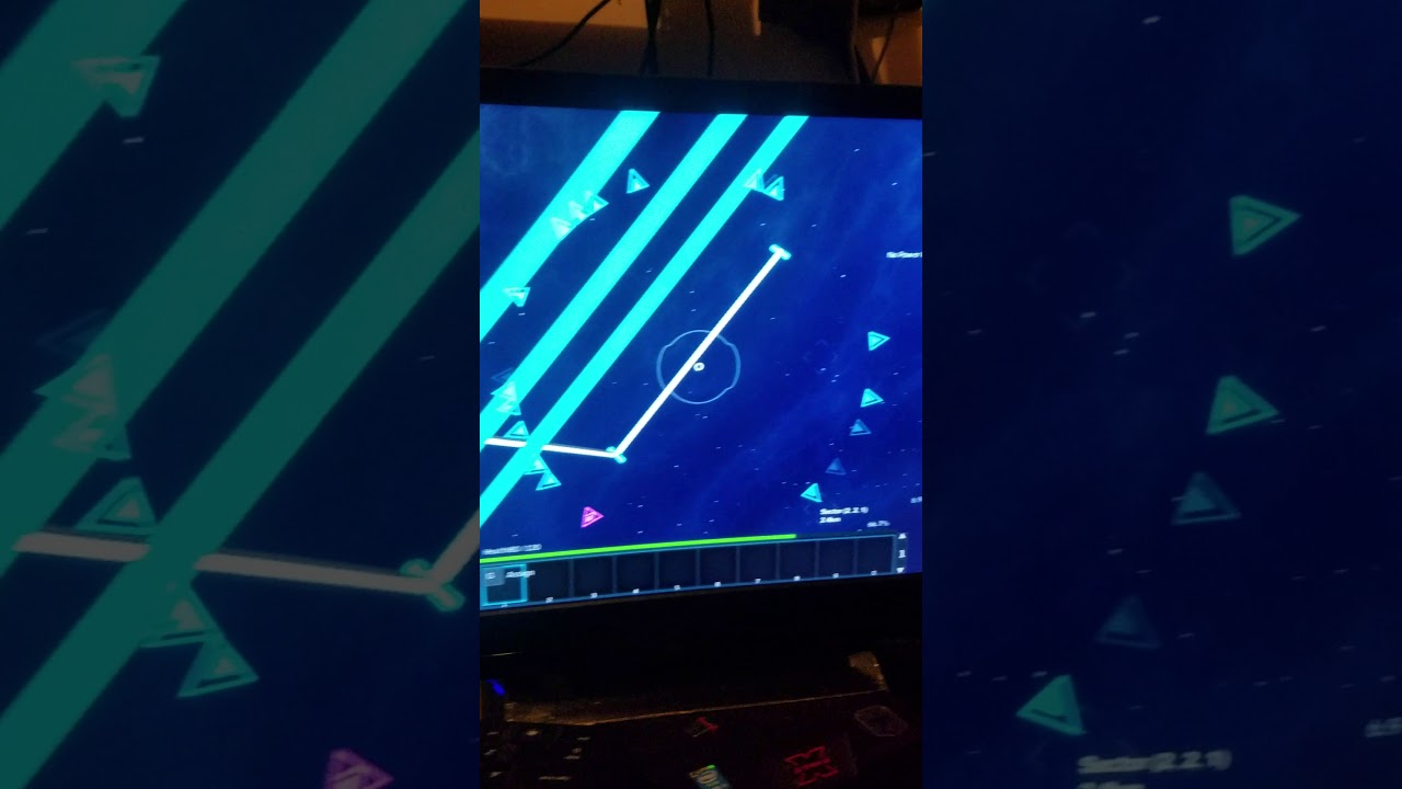

I posted a youtube video where I try to introduce it, but it's REALLY rough, I didn't spend time to think about it much, I need to find a way (maybe someone to hold the camera) that I can actually show it in action,, I can't use the controller and hold the phone.....
I think I will try to find a place to post the project if someone already doesn't have an identical project, or otherwise link to and support the idea, because I used the controller to fly hoops on a course similar to drone racing that I made in starmade (hoops that you fly through), and I think overall it's not only perfectly usable, but a very nice configuration for 6 axis control .
here's my video. I know its youtube but please excuse that I'm not a "youtuber" or video producer, I just use it because then my videos are accessible. I don't make "content", just my little show and tells and such.
