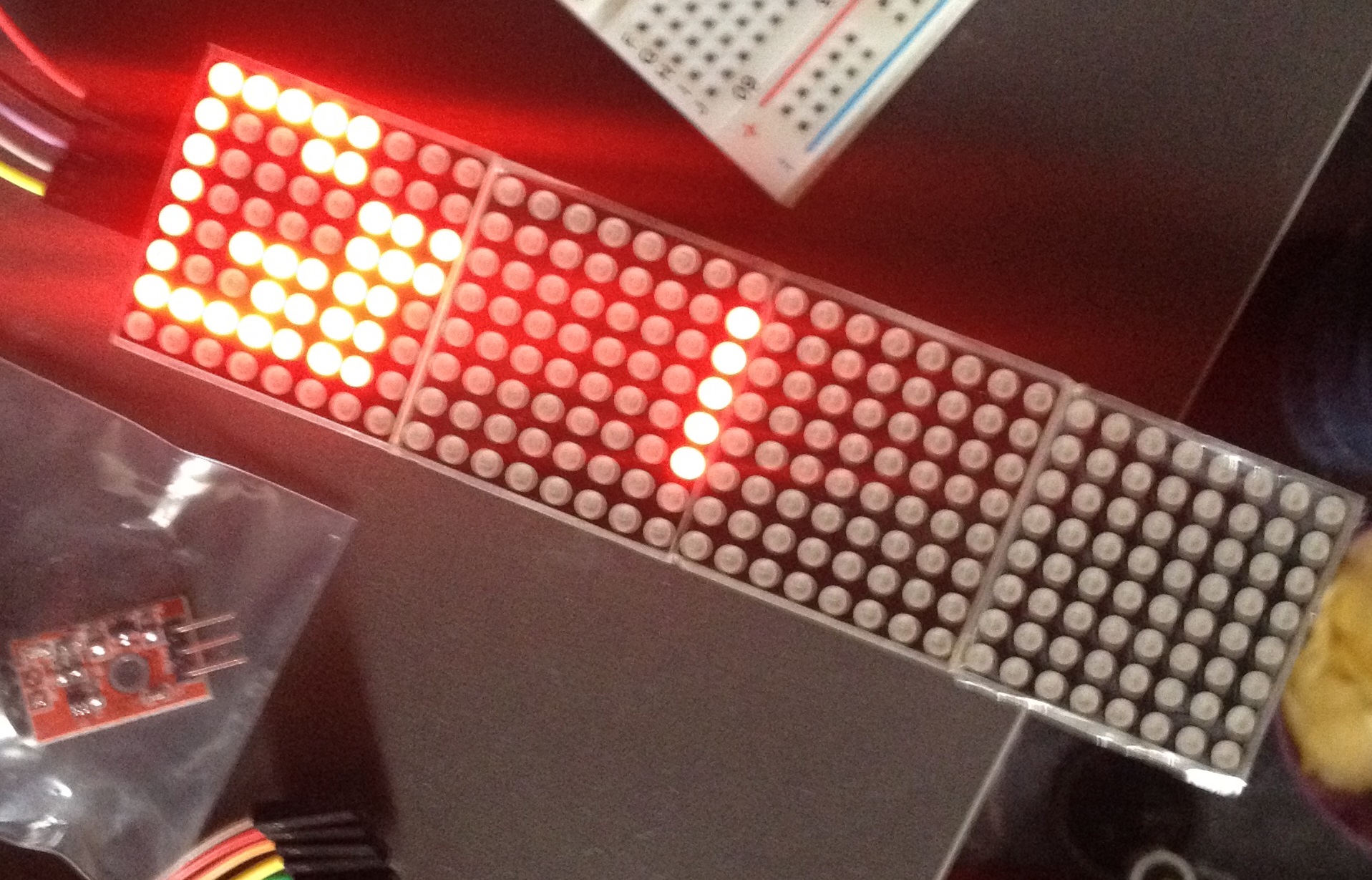

I have a tiny problem with a 8x32 led matrix from china.
You see, it is rotated the wrong way. The display is scrolling text saying "Sander :)" but it isnt displayed properly. it goes from the top display to the next. but it is scrolling from right to left and then it goes to the next display. The matrix is controlled by a max7219 chip for each display. since is are just 4 displays chained together. Now my question is how to rotate the text in such a way that if i hold the screen horizontal it will scroll from right to left over all the displays so it goes from display 1 to display 2, display 2 to display 3 and on like that. The code i am using right now:

I hope somebody can help me with this :slight_smile:

Have a look at the Parola.h library.
https://parola.codeplex.com/
I already tried that library but then it is even worse :confused:
The letters are just unreadable. I seriously can not make out 1 character.
I think the leters are flipped horizontal and vertical.
But I wasn't able to get that library to function correctly.
Maby I am doing something wrong ( I probably am )
But I am just not able to figure it out
  • CrazyVito11
This thread may help.
I guess that you have not read the documentation for the MD_MAX72xx library and set it up to work with your matrix. You need to change a setting in the header file to tell the library what type or matrix you are using. So far there has not been any matrix that has not worked with the library.
It works now, well kinda.
Verything looks good but the order is wrong.
instead of going something like this:
|gre|eet|ing|
it goes like this:
(see the picture)
I hope you can help and i also hope i am not annoying to you :-![
  • CrazyVito11
btw. You're library looks promising! :slight_smile:
Never mind :roll_eyes:
i had the wrong device selected, i checked the media folder and saw a picture of the module i have.
I have the FC16 module.
after i changed it it worked perfectly!
Thanks for the help and amazing library! :smiley:
