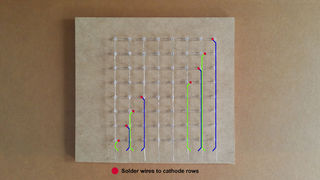

I want to wire 64 individual white LEDs to a cloth in an 8x8 grid. Googling I found that I should use a max7219 to control the leds.
How do I wire the positive and negative terminals of each led?
Each should be able to be controlled individually.

Standard leds have a negative and positive terminal, each row /column would have 8 leds each. I presume all the negatives for all 8 leds on each row have to be wire soldered/joined together and then connected to pin on max7219?
Likewise with the positive pins?

This is how to wire all the LED
Thanks a lot...just what I was looking for :slight_smile:
Just a question in the instructables link....... Why do we need cathode solder wires as we have already soldered the cathodes earlier?
