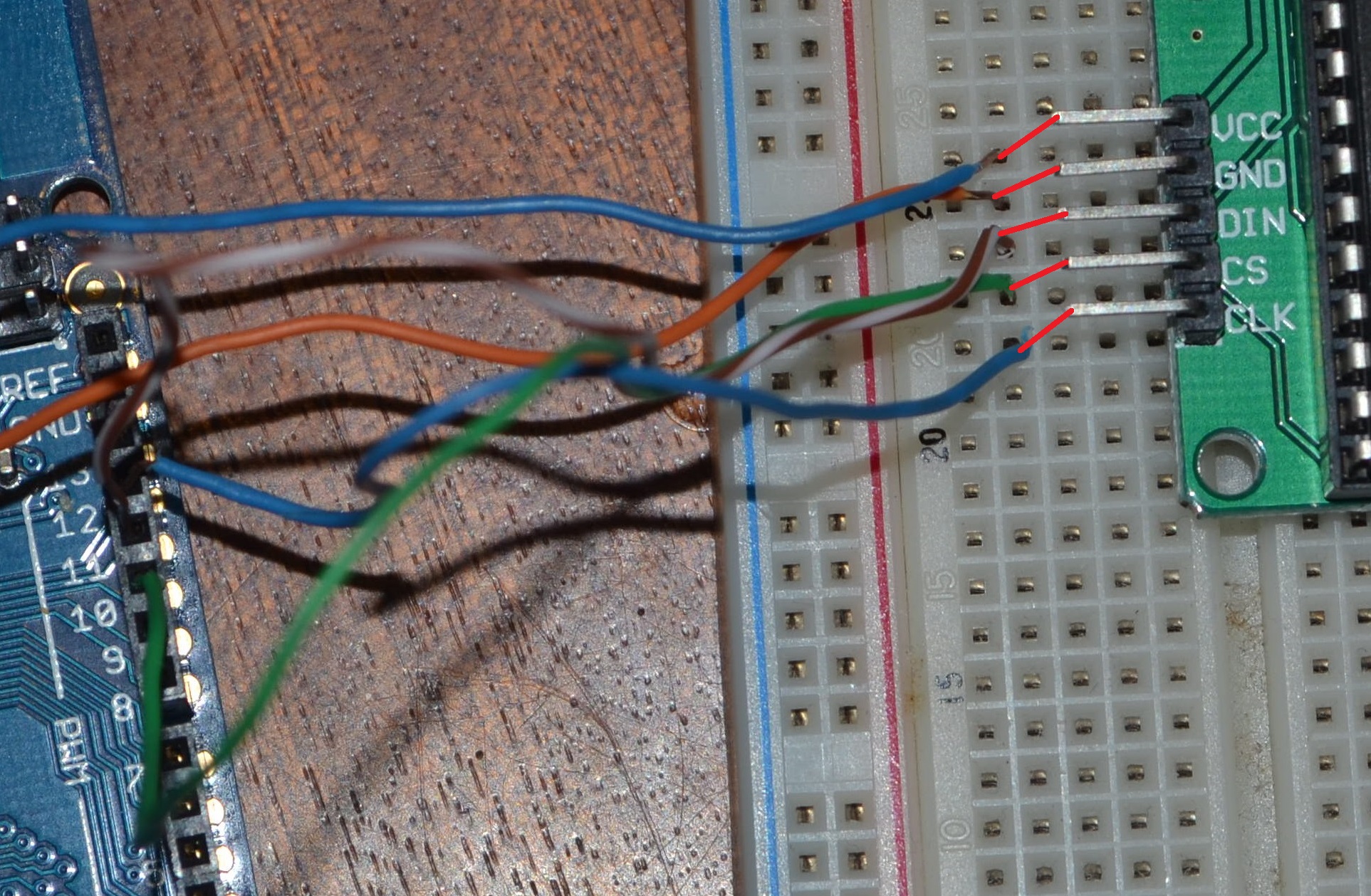

Here is one picture. If you need more detailed, just say.
The thing is we need to see where the wires come from and go to.
It will also help if you post your code ( use code tags please ).
Here is the code with one picture.

That photo does not match up with the previous one. What pin have you got the clock connected to?
I can't see where the ground goes.
I can not see where the 5V goes.
I am supposed to be checking your circuit here can you check it from what you have posted?

Hi!
VCC goes to 5V
GND goes to GND
DIN goes to 11
CS goes to 10
CLK goes to 12
That code you posted is rubbish because it does not initialise the internal registers. It also seems to be constantly refreshing the matrix which is not needed because that is what this chip does.
Your wiring does not match the wiring required for that library used in the instructables page you posted.
So I am very confused about what you are trying to do, perhaps even more confused that you are.
Way back in reply #5 I sent you a link to some reliable code to drive this chip. What have you done with this information?
It uses different wiring than your posted (rubbish) code.
