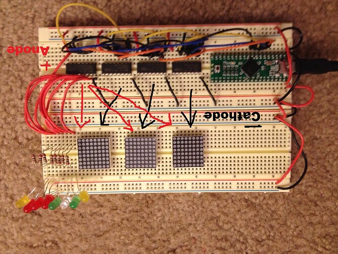

Hello. I am trying to control 3 led matrices using 4 74HC595 shift registers. This a smaller prototype for a larger project I plan on building. To use less resistors I have wired to anode to do the multiplexing. My problem is that the bits don't shift correctly.
The image is wired like so:
MR (active low) = wired to all four shift registers
STCP (Clock) = wired to all four shift registers
SHCP (Latch) = wired to all four shift registers
DIN (Serial Input) = wired to the shift register #1
Q7S (Serial Output) = Wired from shift register #1 to DIN of #2. Q7S of #2 to DIN of #3....ect

You are "bashing your head against a wall" on this one.
It's all very well playing around with 74HC595s to control one 8 by 8 matrix as an exercise, but it really is "playing around". You seem to want to do some serious work with them. By the time you add the necessary buffer transistors or more ICs, and more shift registers, and resistors, you will have wasted a lot of time and frankly, money.
If you are serious, go get some MAX7219s. Even better, just chase up the proper modules on eBay. (Most of us have found "Alice" to be very reliable and not selling junk.)
Yes, MAX7219s and Parola library.
Otherwise, post a schematic. Your picture doesn't have nearly enough wires.
Looks like your plan is to bit-bang out 32-bits, and repeat that 8 times?
Why not use SPI.transfer() 4 times instead and take advantage of the high speed hardware built into the '328P?
