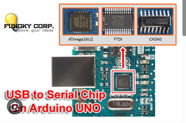

My Arduino Uno has a broken USB chip does anyone know how to fix it?
Desolder it and solder a new one in place; not always the easiest. You might have to program it as well.
What is the chip? CH340? AT16U2?
What are the symptoms? Is the board no longer recognised by your operating system? Or something else?
Alternatively you might be able to use a so-called FTDI cable (e.g. FTDI Cable 5V - SparkFun Electronics) or board (e.g. SparkFun FTDI Basic Breakout - 5V - SparkFun Electronics) and use that.

It’s the chip closest to the USB port. See post #11 for some options; it might also be a CP21… chip.

ATmega16U2
a genuine Uno
Genuine Uno does not use a ch340.
Please show a picture of the board you are using.
as mentioned before, it is not a genuine Uno.
Also, take note that you have to install an additional CH340 driver to your PC to be able work with your board.
