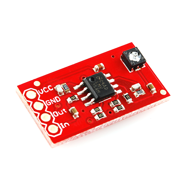

I figured I would need a ampilifier because I am also into av and stuff so ineed to get a amplifier to amplifie the decibel level so it can pick up the load nose of a trumpet
So I was looking at amps and found Op-Amp - AS358P (Through-Hole) - COM-15946 - SparkFun Electronics

I figured I would need a ampilifier because I am also into av and stuff so ineed to get a amplifier to amplifie the voltage so I can get a sensor that is powerfull anough to pick up the sound
Yes, you have the right idea. I was saying that you can get a breakout board with the amplifier (LM358) built in from Adafruit and Sparkfun. Others have said it is sensitive enough to pick up talking nearby using only a piezo mic which is the cheapest mic
in the world I think. If you actually had a "real" microphone (the kind used for stage perfomances) the quality would be much better.
So I can use a breakout board wth the built in amp then wire the mic in or is the nic built in to
One approach to making an Arduino-based sound level meter that records in dB (which is a logarithmic measure) is to use an operational amplifier with logarithmic gain as part of the microphone preamplifier. An example of a logarithmic amplifier circuit is shown here: Log amplifier - Wikipedia but keep in mind that more is required: the log amp works only on positive input voltages. More discussion on biasing can be found here: Logarithmic amplifier | Gas station without pumps
The LM358 linked in the previous post will be fine for this. This approach helps to get around the 10 bit limitation of the built in ADC. Once the final circuit is working properly, it will need to be calibrated by comparison to a commercial sound level meter.
If I use the opamp breakout how would I connect it to the ardiuno uno would I connect the ground pin on the opamp to a ground pin on the ardiuno and the 5v pin on the ardino to the in pin on the breakout board and the mic to the out pin on the opamp.
