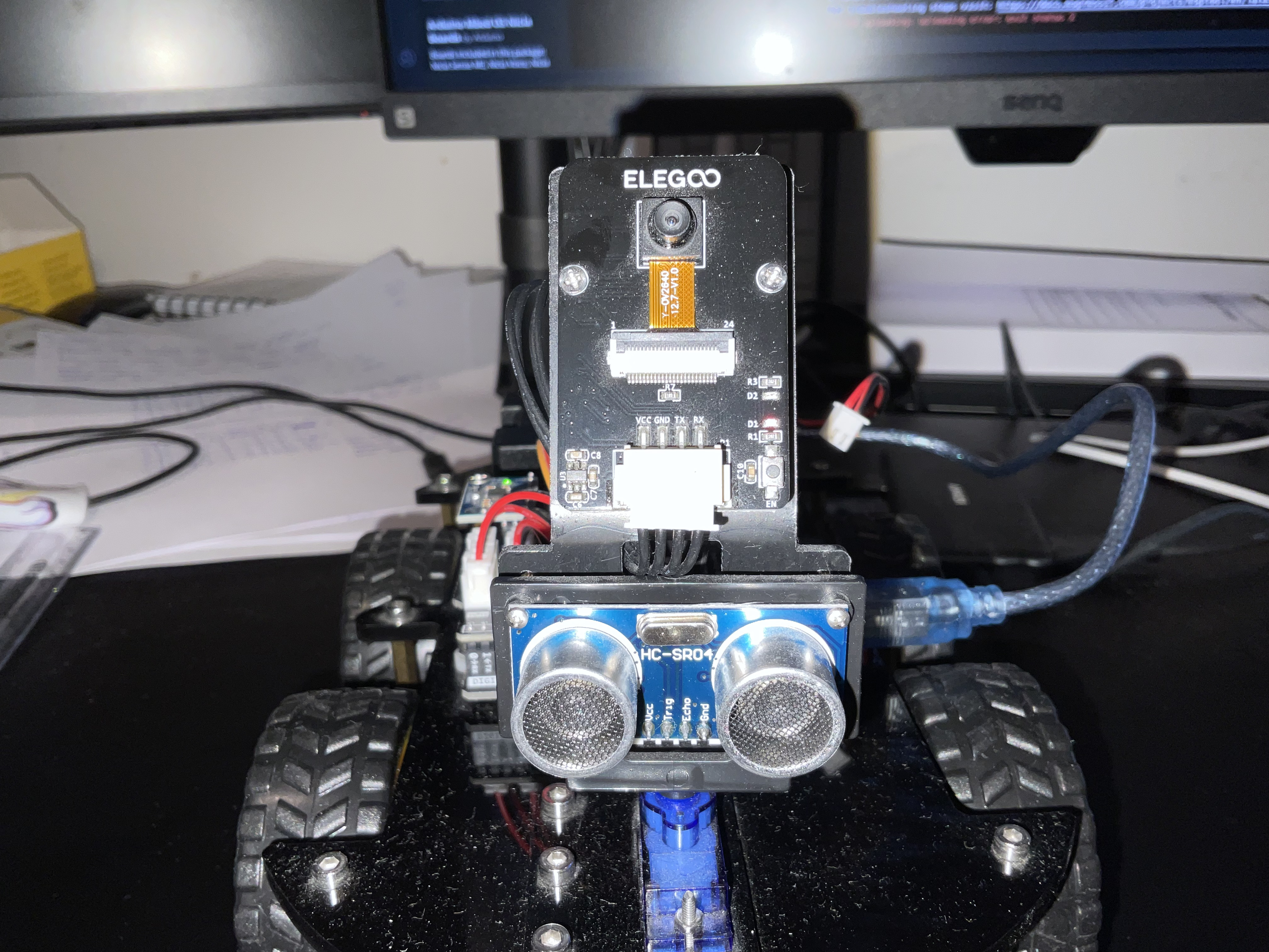

A fatal error occurred: Failed to connect to ESP32: Invalid head of packet (0x00): Possible serial noise or corruption
I keep getting the error in the title when trying to upload a sketch. I have tried to switch to different USB ports, resetting the ESP32 camera wrover, resetting the IO extension board and the UNO. I do not believe I am missing any drivers either.
The wiring is all correct according to the assembly instructions of the starter kit, so I do not think it is an issue with wiring like other similar posts.
This is the output when the sketch fails to upload, I cannot find anything on the troubleshooting site which has fixed it either.

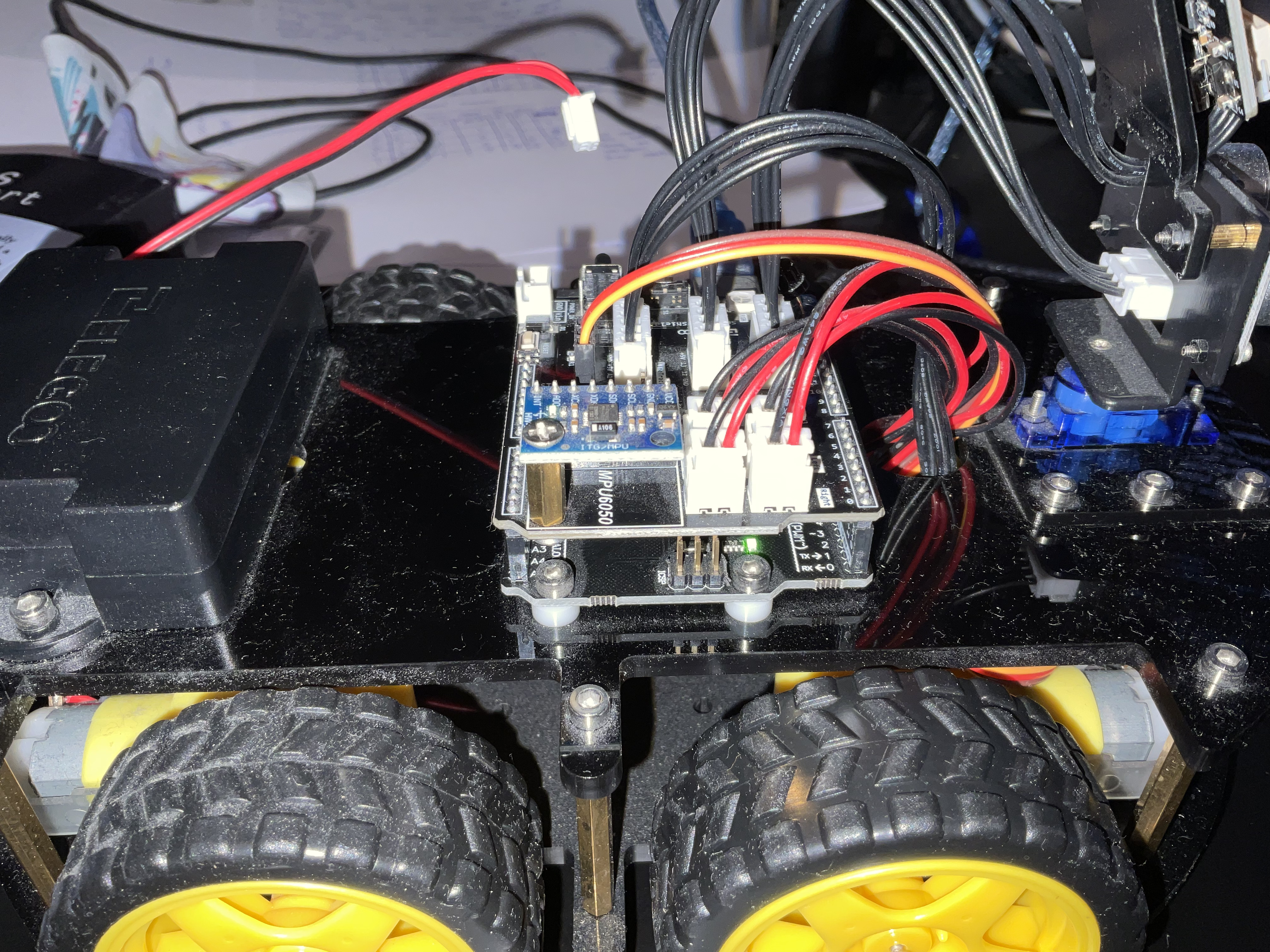

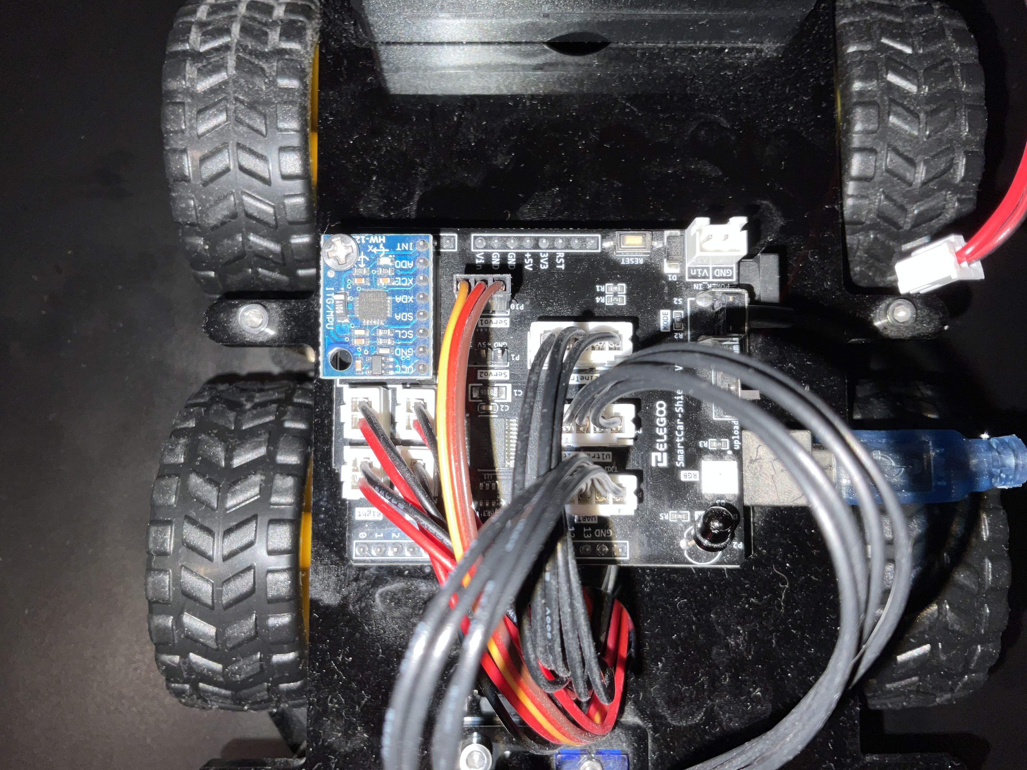

It is possible for a short or external circuitry connected to the Arduino board to interfere with the upload process, causing this type of upload error.
Make sure the board is not sitting on anything conductive that could short the contacts on the bottom of the board. Make sure there isn't any conductive debris (e.g., strands of wire or component leads) on the board or on the surface the board is sitting on.
If you have a shield or any external circuitry or components connected to your Arduino board, try this experiment:
  1. Disconnect the USB cable of the Arduino board from your computer.
  2. Disconnect any shields, modules, external circuitry, etc. from your board.
  3. Connect the Arduino board to your computer with a USB cable.
Now try uploading a sketch to the board again. Does the upload succeed?
This experiment will determine whether the upload error was caused by interference from your external circuitry. If so, you can then focus your attention on identifying the specific problem with the circuit and resolving it.
You took some nice photos but it appears you have a dirty lens or screen. Do you have anything connected to pins 0 and 1, the terminal serial pins, if so remove it and try uploading again.

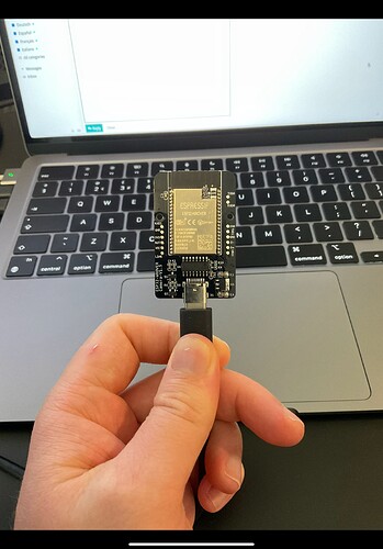

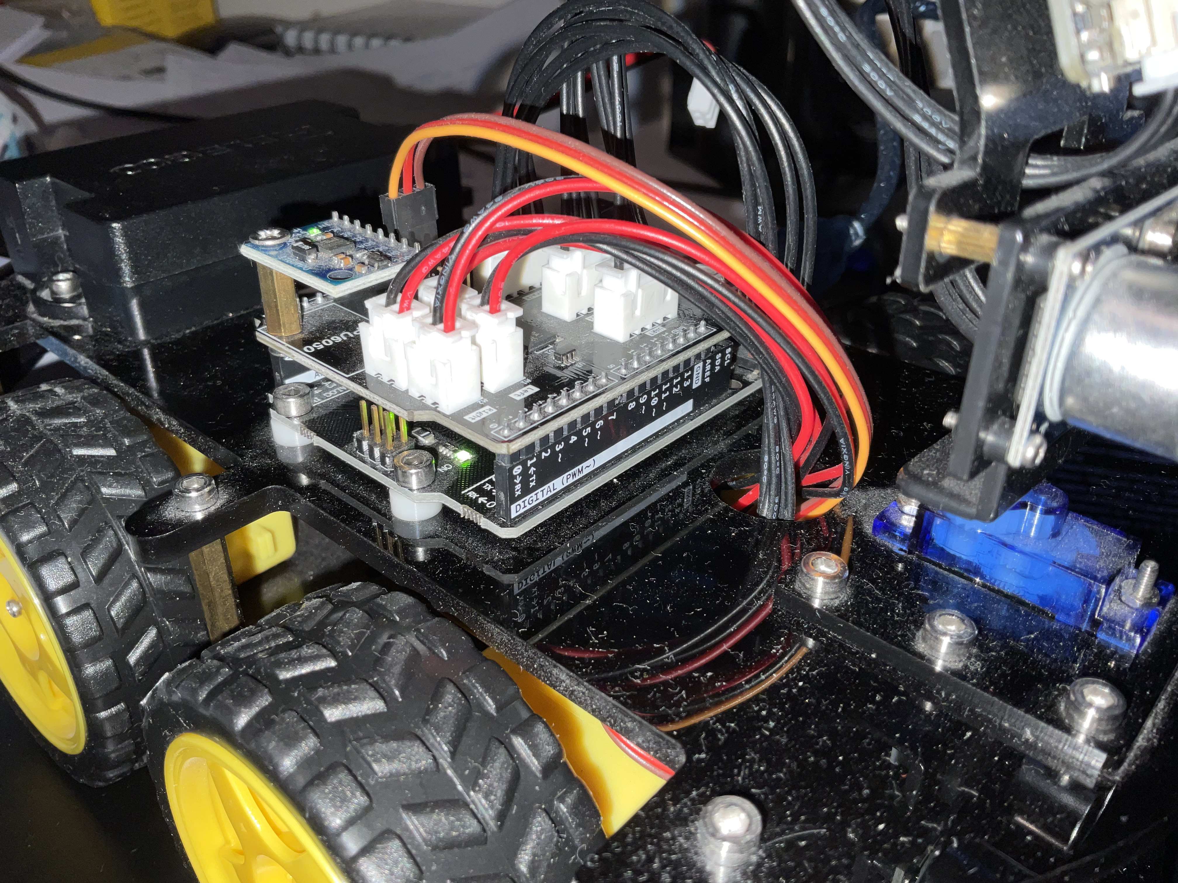

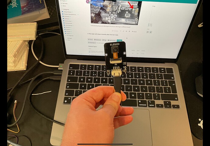

When I directly plug the board into my computer via USB-C, there are no LEDs at all so the board does not turn on at all. The manufacturer said they would replace this part so I think I will just have to develop the robot without the camera for the mean time.

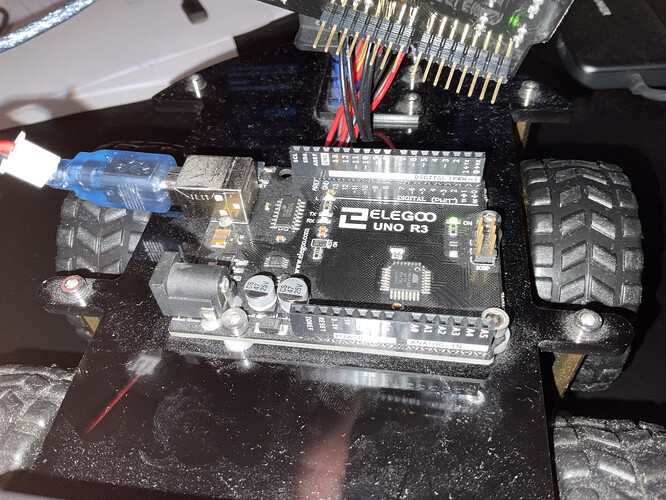

That is very odd because in post #1, we can see clearly that indeed the "ON" LED on the UNO R3 derivative board is lit when you only have it connected to the computer:
Is this the board you are referring to? Or are you referring to a different board?

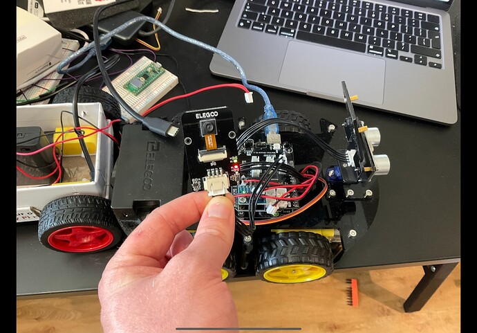

Sorry I should have been more specific, I was referring to the ESP32 Wrover board. When plugged in directly, the LEDs are not on, nor does the WiFi network appear on my computer. It only appears to be working when it is plugged into the IO extension board. Here are images of it:
I'm very doubtful that is a USB socket:
Further evidence is that the pins are labeled "RX" and "TX" on the PCB silkscreen. A USB socket doesn't have RX and TX pins so it would not make any sense for someone to label the pins this way. It would make perfect sense to do so if the connector was instead used for a serial interface between the UNO R3 derivative board and the ESP32 microcontroller on the camera module (and using USB for this interface would not make any sense at all).
It looks like you just jammed a USB cable into a connector that happened to have dimensions that are somewhat similar to USB. That will never work! This explains why the upload was failing.
You might have bent some of the contacts in the connector when you did that. You should carefully remove the USB cable from the connector and then do a close visual examination of the contacts in the housing. If they appear bent, try to carefully correct their alignment. Otherwise you might severely damage them when you insert the real plug into the connector.
Sorry I took the picture with the board the wrong way around! Dont worry, I didn't jam the USB into the socket! The USB connector is on the back of the board. I was just trying to show how the board only appears to be on when plugged into the IO extension board. I've retaken the pictures.
Here is the board appearing to be on when plugged into the IO extension board:
Here is the board when plugged directly into my computer via USB-C and not appearing to be on:
Ideally I would not have to send for a replacement since I've been stuck on this for several days now but I cannot find anything online about this.
Thanks for the clarification.
It is cool that they put a USB interface on the camera module! My assumption was that the board only had a serial interface, as is the case with the standard "ESP32-CAM" boards (which are typically used with a separate "motherboard" that provides the USB interface). They went the extra mile to spend more on extra components that were not absolutely necessary in order to make it easy for the user to update or modify the firmware on the camera module's ESP32.
It is not clear what the LEDs on the camera module are intended to indicate as the labels on the silkscreen don't provide any useful information (the "D1" and "D2" labels are just the component identifiers from the module's schematic). There is a small possibility that these LEDs are not power indicators, but rather indicators for the RX and TX activity. In that case, it could be expected that they wouldn't light up when only the USB cable is connected, even though the board is powered.
