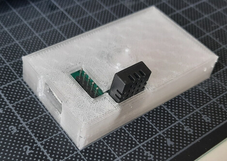

Sort of; I have a sensor in each room that records temperature and RH and logs it into a database every few minutes. It doesn't control anything as such. The sensors are DIY PCB's based on an ESP8266 and powered from a simple USB charger. Connectivity is through WiFi. The setup has been working dependably for a year or two now. Here's an unused spare that I never put to use:
It's a simple affair made with a generic/off the shelf ESP module, a linear regulator to make the 3.3V supply, a 3-color LED, DHT sensor and a button. Programming is through the pin header which breaks out a UART interface.
There's one slightly 'smarter' device part of this same system in our living room that has an ePaper display that plots energy use/generation, temperature humidity and air pressure; it's ESP32-based and also WiFi connected + USB powered. It gets some of its data from a smart meter, some from its own sensors, some from the central database.
