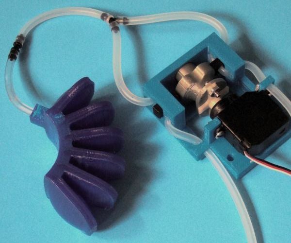

Working on the basis of perilastic design, you could use a small servo type motor to squeeze the tube flat to stop the flow then de-power at that location. When you want flow, re-power servo and drive it to "un-squeeze" the tube then de-power again.

How about a small quarter turn ball valve operated by an RC servo? Turn servo power on, operate valve, turn servo power off.

Thanks everyone for their great ideas!
Jackrae inspired me to find this project
Which I think will do the job
