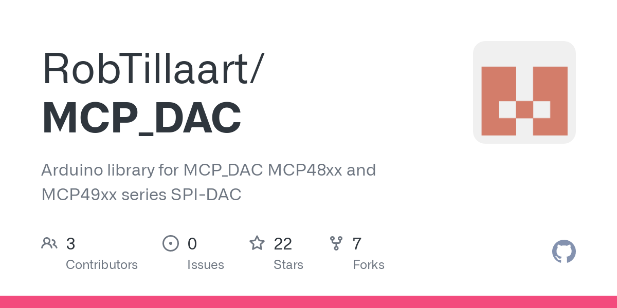

Are you familiar with the MCP48XX and MCP49XX series?
Communicates over SPI so pretty fast.
I haven't found any that will allow me to easily connect 8. i.e running out of IC2 channels. Plus I did think about multiplexing but that would make the waveform a bit choppy and as its for music even if it was very high frequency I wanted separate DACs
These look good only up to 2 channel though, looking for 8
But guess it would be easy enough to connect 4 of them, and there is an Arduino Lib, cool. Thanks
