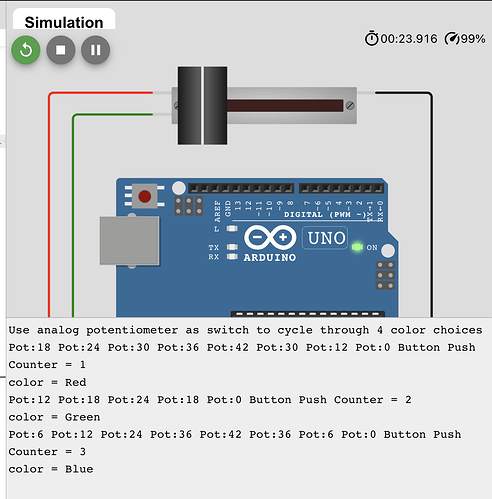

Here's an adaptation of @groundFungus's code to detect changes in an analog potentiometer reading:

Tested only in simulation:
I left @groundfungus's counting and color-switching code, and tied to analogRead(A0) == 0 to demonstrate parallels between analog state change detection and digital state change detection.
Your problem could use a bit of both:
  • when the button changes, change the adjustment color like @groundFungus's code,
  • when the potentiometer changes, change the color of the LED based on the potentiometerState and the color.
