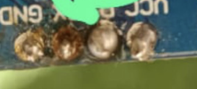

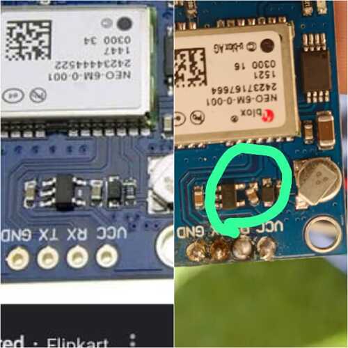

Our GPS module looks little displaced. (AS IN THE IMAGE ATTACHED). Is the displacement in the GPS module the reason for the GPS led not blinking ?

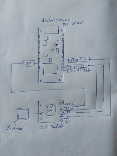

Here is the schematic of connections we made:
Vcc of gps -5v pin of Arduino
Gnd of gps-gnd of Arduino
RX pin of gps-Tx pin of Arduino (defined in program)
Tx pin of gps-RX pin of Arduino (defined in program)
Does your GPS module talk (Tx) with 3.3V or 5V ?
Your arduino is a 3.3V system, GPIOs should not be exposed to higher voltage
To your initial question, the resistor that is poorly soldered could be an issue if it’s not touching its pad or touching electrically a nearby component. From what you posted it appears to be fine but worth checking and definitely Not great quality

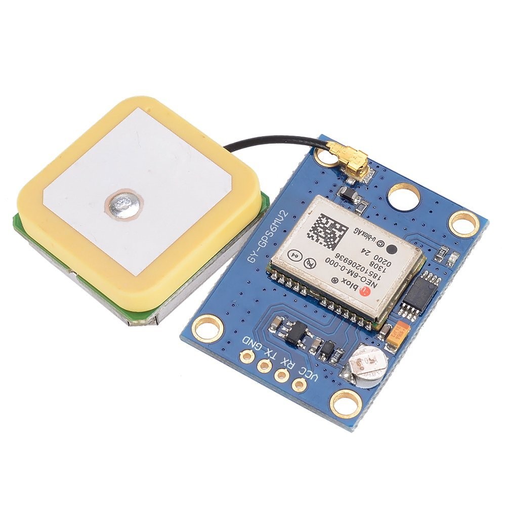

The picture shows two Neo 6M GPSs, these modules are standard Serial GPSs.

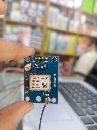

Only one with its attached antenna
Voltage adapter might be needed - possibly already destroyed the Rx pin of the Nano BLE if sending 5V….
I did not see any antennas.
On all the Neo 6Ms I have seen the antenna connection is on the end of the board not show.

I think the pic was to show the poorly soldered resistor (left is the image from the site he ordered from and right is what he got - that’s how I understood it)
On a second sight - the pins are really poorly soldered too. This needs to be re done
