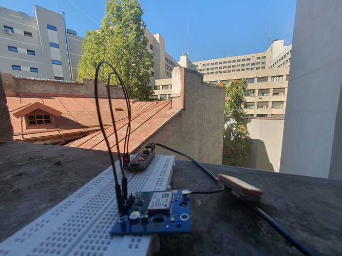

Hello guys. I am using an arduino nano, and a gps module neo 6m 0 001, and i can't get the led of neo 6m start blinking. From where i read, they say it cannot connet to sattelites. I am in a clear area outside. It s the second neo 6m gps that i am trying to start. I was waiting for more than 2 hours. Maybe is a software problem?

I would not describe that as a 'clear area outside'
Judging from the shade, the view vertically up is blocked and the view to the horizon in front, and maybe behind, is also blocked by buildings.
i went in the middle of nowhere.

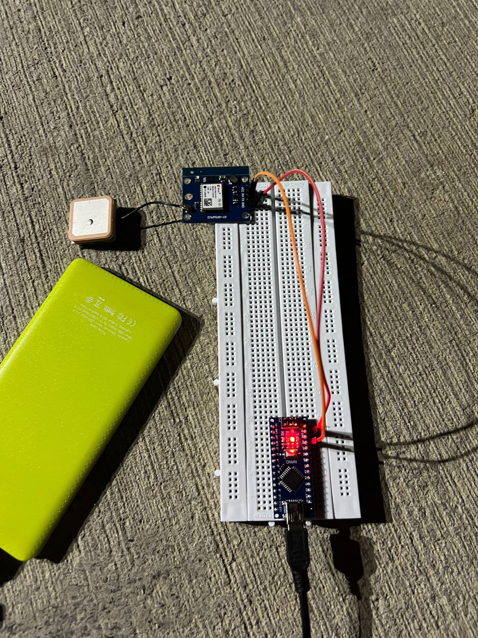

Here;s the connection. Like this if i measure with a multimeeter , the pins VCC and GND of NEO GPS i got ~4.7V
The red light, just appear for 3 second and goes off when antenna is not attached. And i was in the middle of nowhere, for more than 1 hour, nothing happend. I am preaty sure the module is powered correctly, because i coonected the arduino nano and gps module without breadboard(directly) and it s the same problem.
i see nothing on serial monitor... :cold_face:
Something wrong there, you should see the 'GPS_Echo Starting' message even with no GPS connected.
