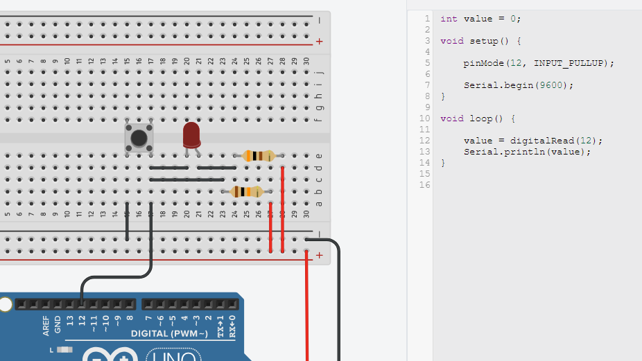

A proper way to use a button and an LED
Could somebody please explain the reason the following circuit works "fine" (LED is on if the button is pressed) only if the Pin 12 is in the OUTPUT-mode?
I need to be able to digitalRead() the button state (pressed/not pressed) and the LED should be on every time the button is pressed without using two pins (one input and one output).
What is the proper way to achieve that?

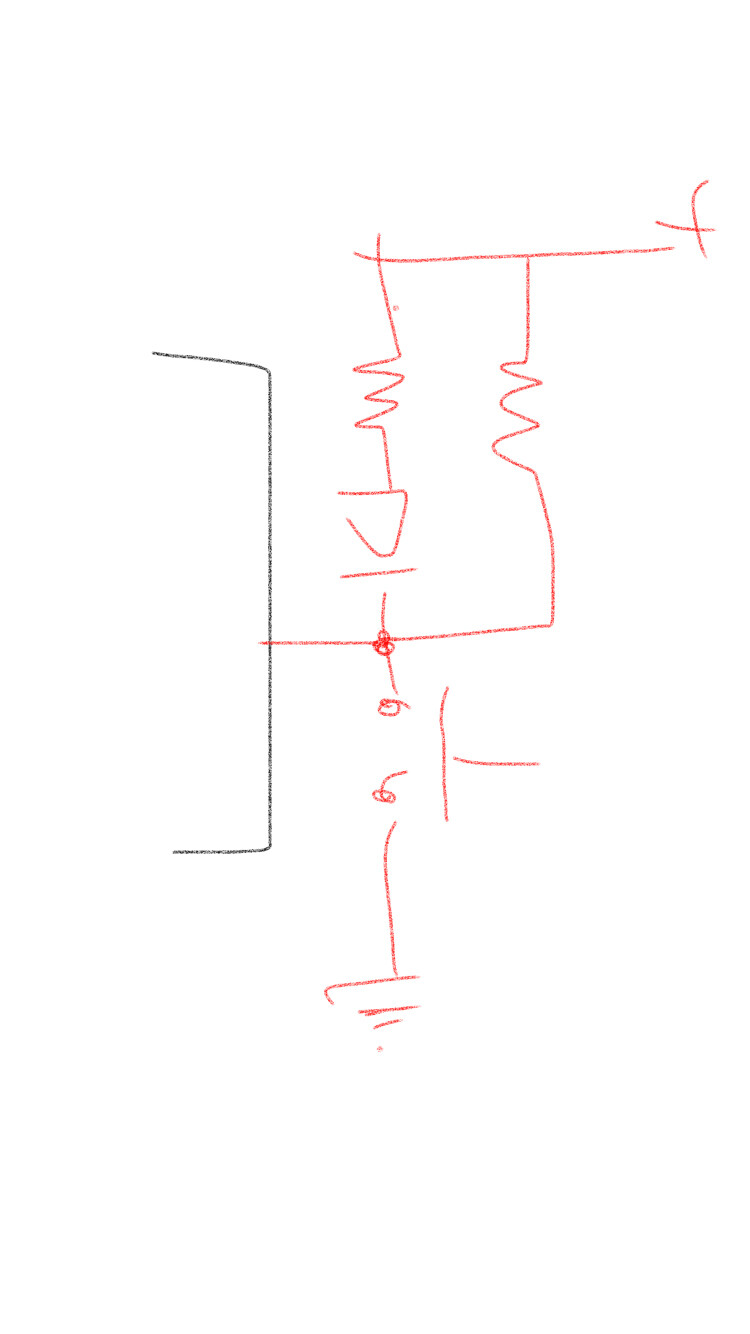

Then put the switch and LED circuit in parallel. Your series circuit will get you in trouble with the LED's forward voltage bias.
Try this with
pinMode(12,INPUT_PULLUP);
LED resistor 220~470, switch resistor ~10K
Yes, like that. Actually you can remove the 10k with using INPUT_PULLUP.
How wrong is this one? I'm reading 1 if the button isn't pressed and 0 if it is pressed.

The only difference is that it takes about 200 times longer to read in this wayward Fritzy kind of form.
Great! It works almost as it should. Is there a way to get actually 0 instead of 1 if the button is not pressed?
You could budge something together with a mosfet or npn transistor to buffer the input to the pin. But why bother? In your code it doesn't really matter if 1 is 'pressed' or 0.
