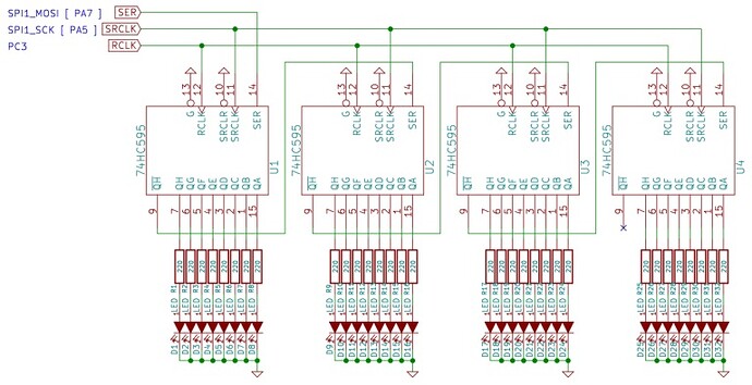

You use 3 I/O pins on your controller to output to 8 I/O on the 595.
595's can be daisy chained so the same 3 pins can output to 8 ,16, 24, 32 I/O.
For example;
Tom...
